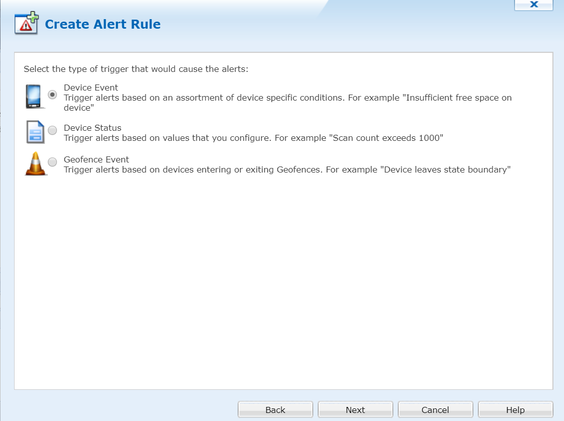

Thank you for your response, please go to rules -> click on Alerts -> create new
1. Select Device Event

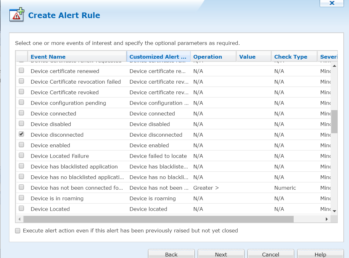

3. Select Device Disconnected -> click next -> select device group -> click next -> following window will be opened

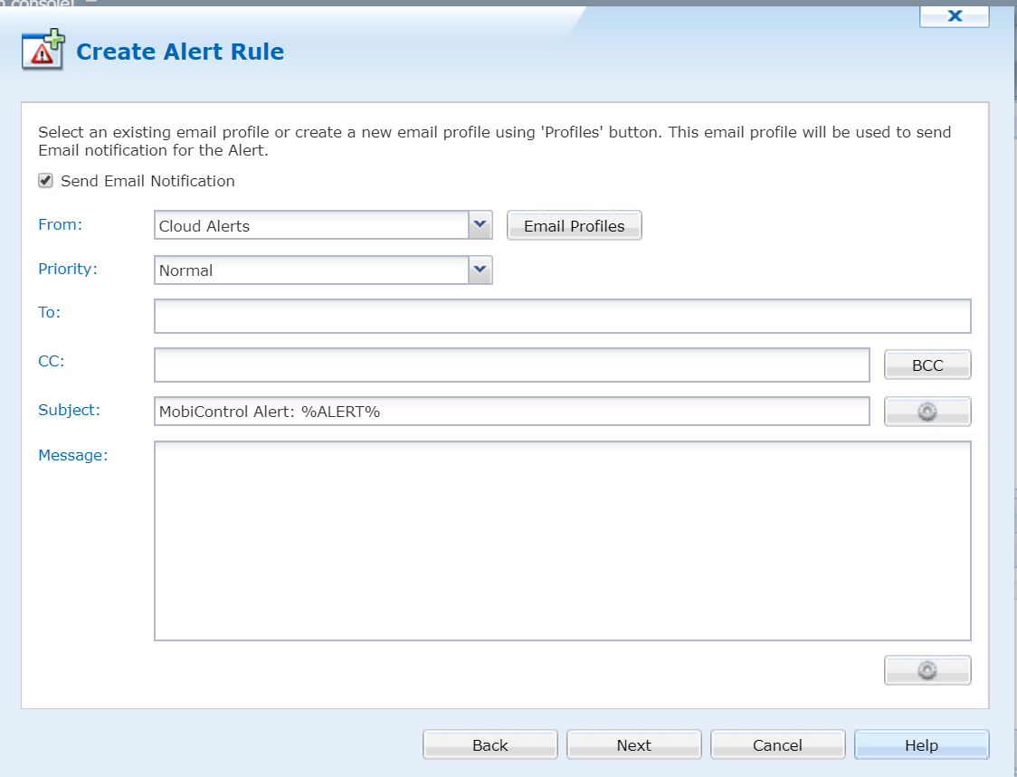

4. You can set-up email notification and click next and finish
