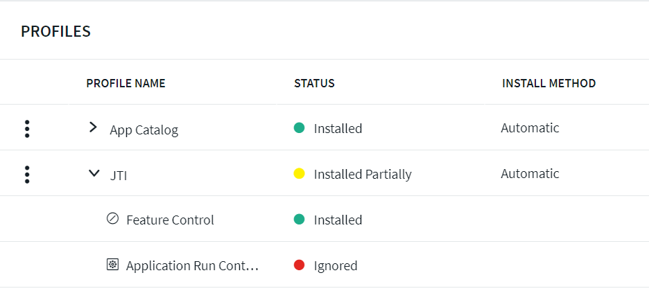

Dears, I am trying to enroll new IPAD device , but it enrolled partially ,check the below message,
when i check the log i found a message says : (Failed to install payload 'AppWhiteBlackListSection' in profile 'JTI', because the device is not supervised.)

Can you double-check that your device is supervised? That is a prerequisite for this to Profile Configuration to work.
How to check:
Web Console -> Click Device -> Device Details -> Look for "Device Statuses" -> Check "Supervised" row.

Status says NO , its not supervised , it was supervised before i do WIPE  action on it .
Thank you, i will check it from my side .
