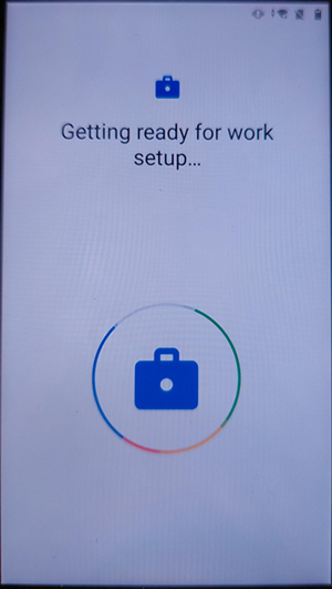

When we try to scan this QR code while pressing 3x times the welcome screen on an factory reset device and scan the QR code, it´s stay in "Getting ready for work setup..." and I can see really many connections to the internet which are blocked by the firewall but none to the internal sources.

This offline provisioning method worked with an Android 8.1 device (LGE  LM-Q610.FGN), but it did not with an Android 10 device (Sonimtech XP8800). It got stuck on the screen "Getting ready for work".

When scanning this it's also stuck in 'getting ready for work setup'. I see the wifi icon after scanning the QR but the .apk never gets downloaded according to our webserver logs. When I copy paste the apk url on a working device connecting to the wifi the download does start so the url/server is correct. Any solution?
