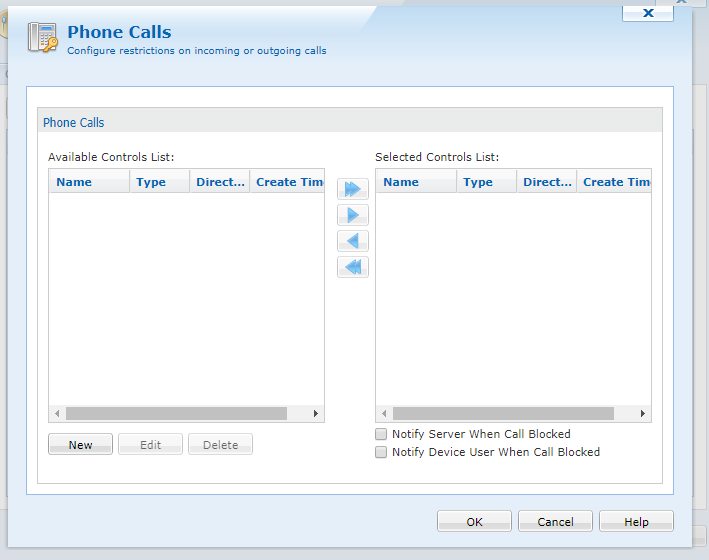

1. Enrolling future devices as Android plus as the feature to manage phone calls is available as a profile in that enrollment method. See the picture below.
