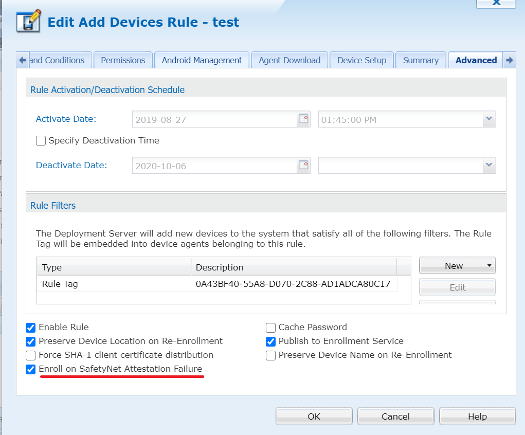

I've already maintained the necessary setting in the add device rule to enroll on attestation failure. But why are these devices failing when they are straight out of the box and unmodified?

Thank you for your post, please try to edit your rule to allow Safety Attestation failure, this option is available in Advance option while creating the rule.

Thank you. I am aware of and have maintained that config in my add device rule. I am more concerned that the SafetyNet attestation failed for the device.
