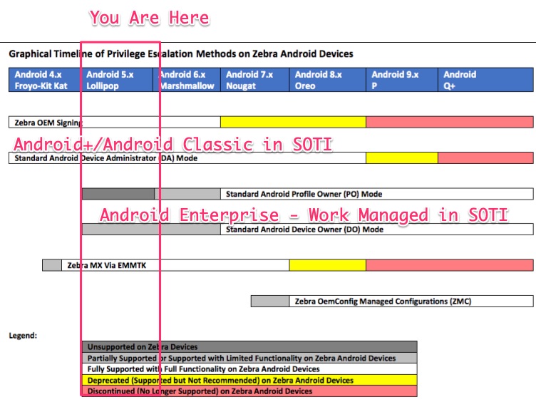

Android L was so early in the AFW/Android Enterprise proliferation that I would argue that it doesn't even really support that management style. The framework for AFW was put in way back then but it is extremely limited.
TC70s running L should be managed under Android Classic / Android+ using Device Administrator based management. There is actually a built in MobiControl Stage app in the TC8000 and TC70 OS that should enable you to directly enroll into the environment without having to install anything.

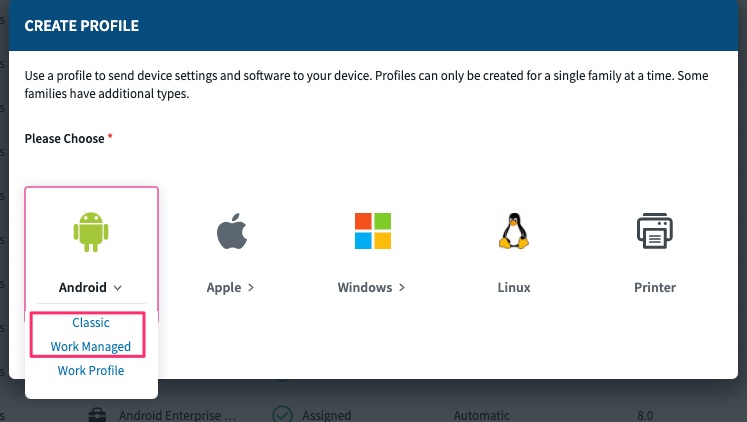

Unfortunately for you, running a hybrid environment of Android Enterprise (DO) and Android Classic (DA) devices will result in a duplication of most of your Profiles as you need to create separate Profiles for each given that the architecture and capabilities are different.
Keep in mind these are concepts that are fundamental to Android management and not specifically a problem with SOTI.
