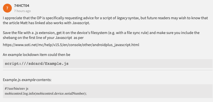

74HCT04
3 years ago
Yes, the shebang is required.
I wish the documentation would clarify where it and is not required, since MobiControl will complain if you use it where it is not to be used.
