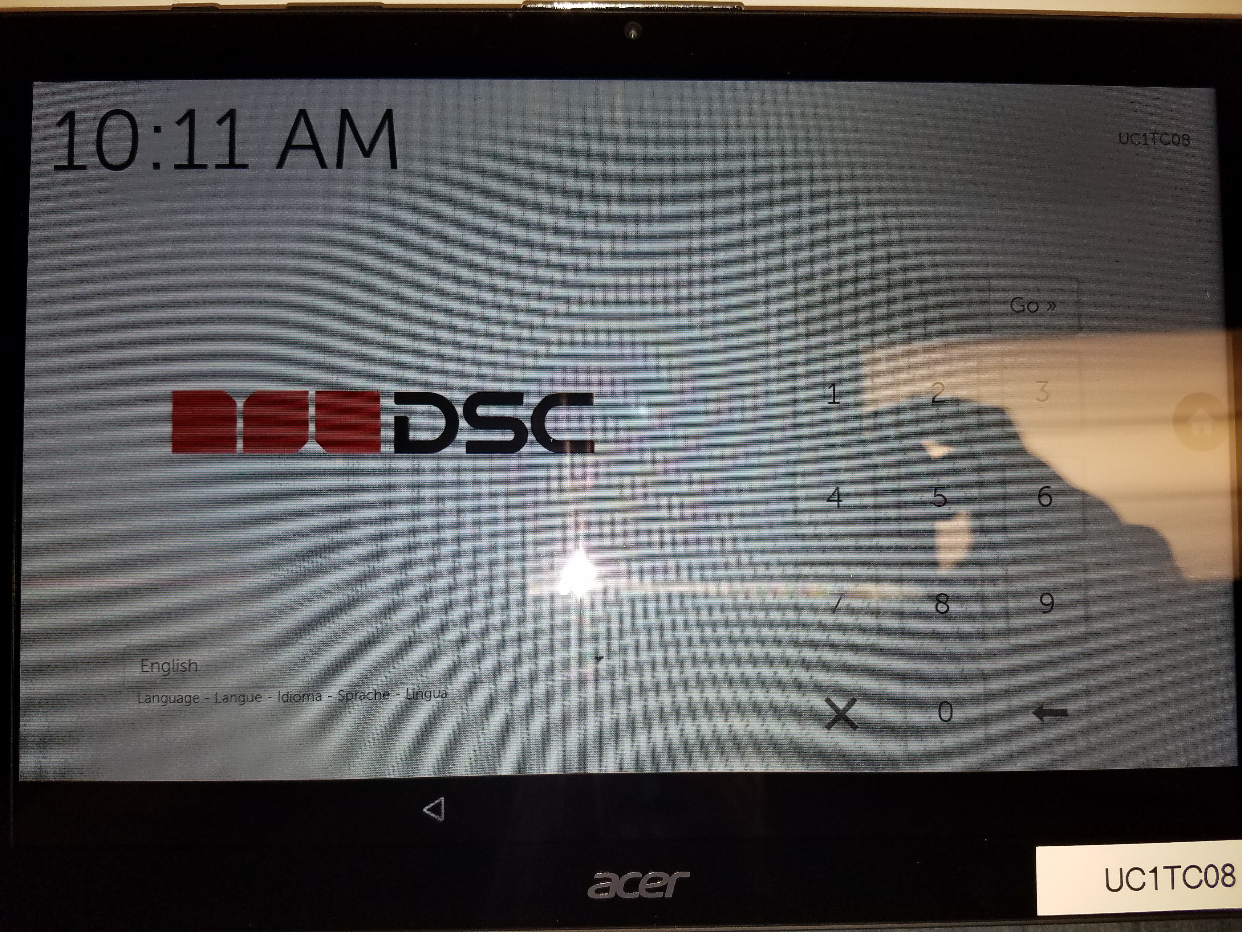

I created a profile that has Feature Control, Kiosk Mode, Soti Surf, Out of Contact and Authentication.  Within Kiosk Mode, I have Soti Surf (Launch://net.soti.surf) and have it automatically start.
Within Soti Surf, I whitelist the URL we point to.  I have Enable Home Screen and Enable Kiosk Mode checked.  I've attached a picture of what our screen looks like if this helps.

The tablets are about 5' off the ground so they can be reached, but depending on the height of the person trying to reboot the clock, it may be kind tough.  The mount that holds the tablet also makes it difficult for the user to get their finger in there to push the power button.  Some sites only have 1-2 clocks which isn't a big deal.  Some have up to 13 clocks and have to drive around the building resetting them if needed which makes it difficult.
If you press the home key or the left back key (bottom of screen) it takes you back to the kiosk mode home screen that has the Soti Surf icon.  If you hold the home key down from the home screen, it'll present you with the menu for administrator mode (to exit kiosk mode) and a refresh key which appears to do nothing.
