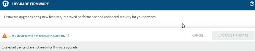

But when i'm there and choose on the assigned device (TC51 with LifeGuard-Update 14) the firmwareupdate i get an error message:
What OEMVersion is the TC51 currently running? It may not meet the minimum threshold of Android N + LG19.

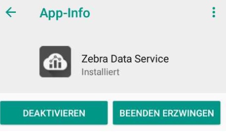

I have done all requirements. Where i can see if ZDS is enabled? I only found this regarding that:

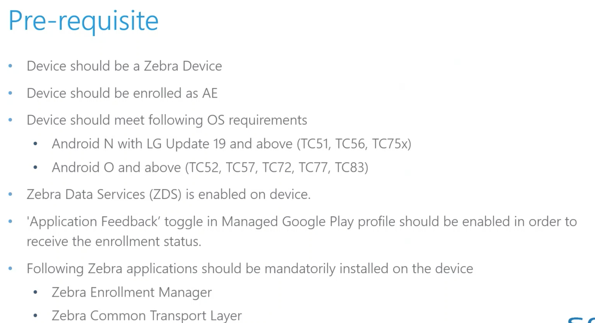

From the documentation, ZDS should be enabled by default:
As long as you are meeting the above pre-requisites then I suggest opening a case with SOTI Support so we can have more of an in-depth investigation. You can open a case by logging it online (Log a Case (soti.net)) or by emailing support@soti.net.

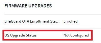

I saw now following in device details:
Is that something which could help you to say me whats going wrong here?
