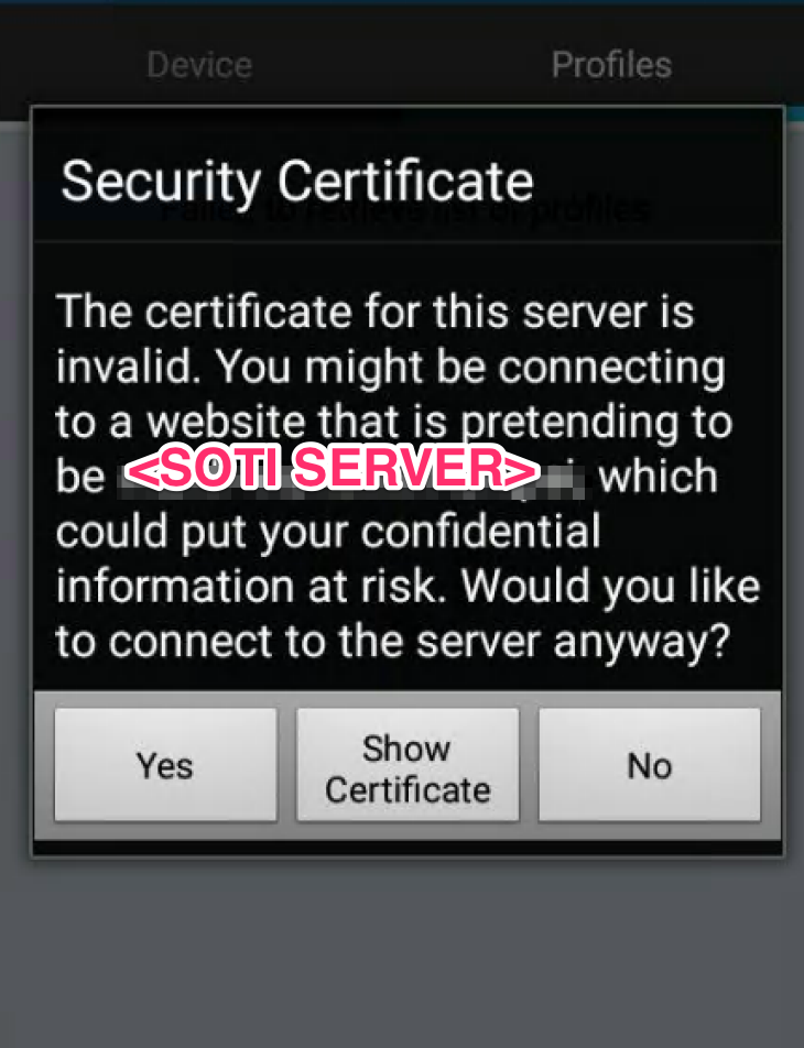

As far as the enrollment goes, I was attempting to leverage the MobiControl Stage agent that is pre-installed on the devices (Zebra Android) instead of having to sideload the INI file. The sideloading process does works but I wanted to eliminate having to cradle the devices or push the file to them via StageNow when I should be able to scan an enrollment barcode in MobiControl Stage. I ended up figuring out a url I could use that matches up with the enrollment rule by going through the Web based enrollment first but I'm still running into a lot of Cert issues. Granted, the devices are being successfully managed by SOTI, but the end user is often faced with these prompts:
Cert errors
