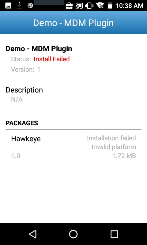

MDM plugin doesn't works, mobicontrol log said: "invalid platform"

Filippo,
It looks like that you enrolled the device in PO mode and not in DO mode. Please enroll the device in DO mode and test the plugin again. I dont have any issues with this plugin on TC20/TC25 and remote control works fine for me.

I've enrolled my device in DO mode but now all pre - installed applications (including enterprise apps) have been deleted! and remote control works but file system explorer during remote control doesn't! I can use remote control with MDM plugin but I should install enterprise apps such as: datawedge (very important), stage now and others.

I am aware that file system explorer during remote control doesnt work on TC20/TC25. There is opened case with SOTI support for this.
There is no signed agent for TC20/TC25 as for other devices like TC70...etc.
If I enroll my device in DO mode then all apps are still installed on the device. We need to know how you enrolled the device onto SOTI. Heve you used  StageNow to enroll the device onto SOTI (DO mode)?

Hi Matt,
it seems to works, I tried with Chrome...I will try with datawedge.
