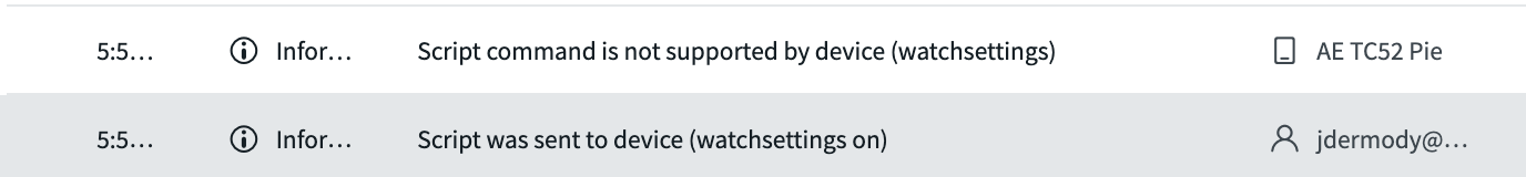

watchsettings is working for you with and Android 9.0 device presumably managed under AE? I haven't been able to use that under AE at all on Zebra devices on 9.0. What manufacturer, server, and agent version combination do you have?
