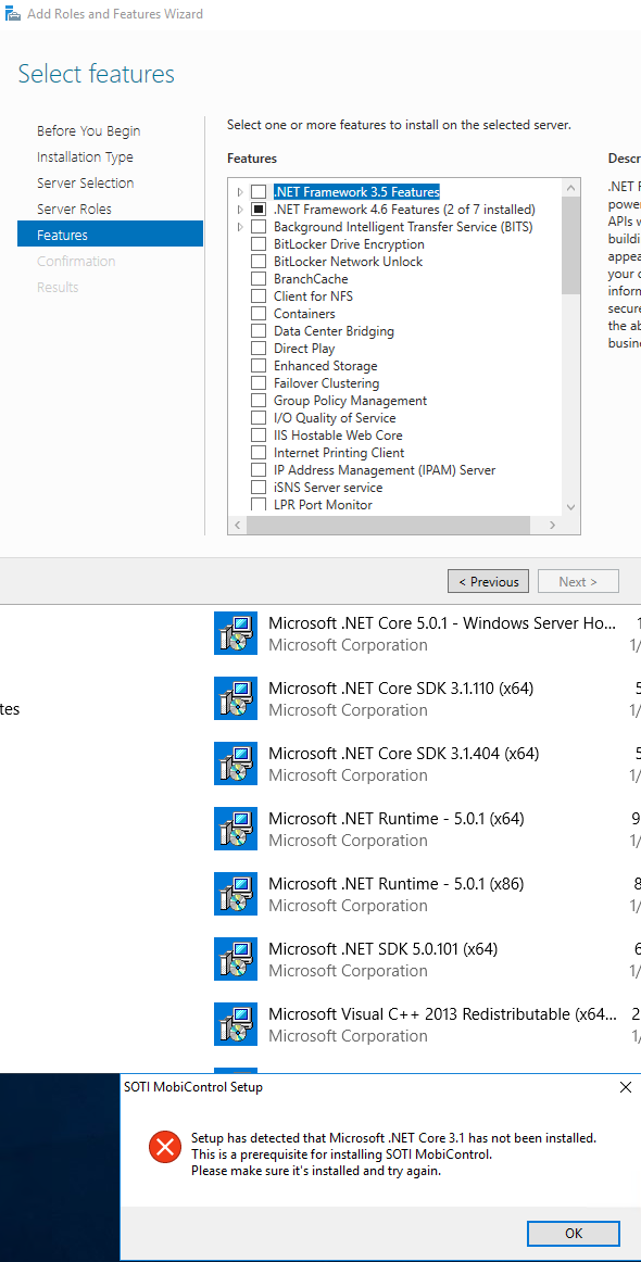

Just got a new server build with Windows Server 2016 and trying to install Soti Mobicontrol. But get .NET Core error even thus is has been installed.
any idea how to fix this?

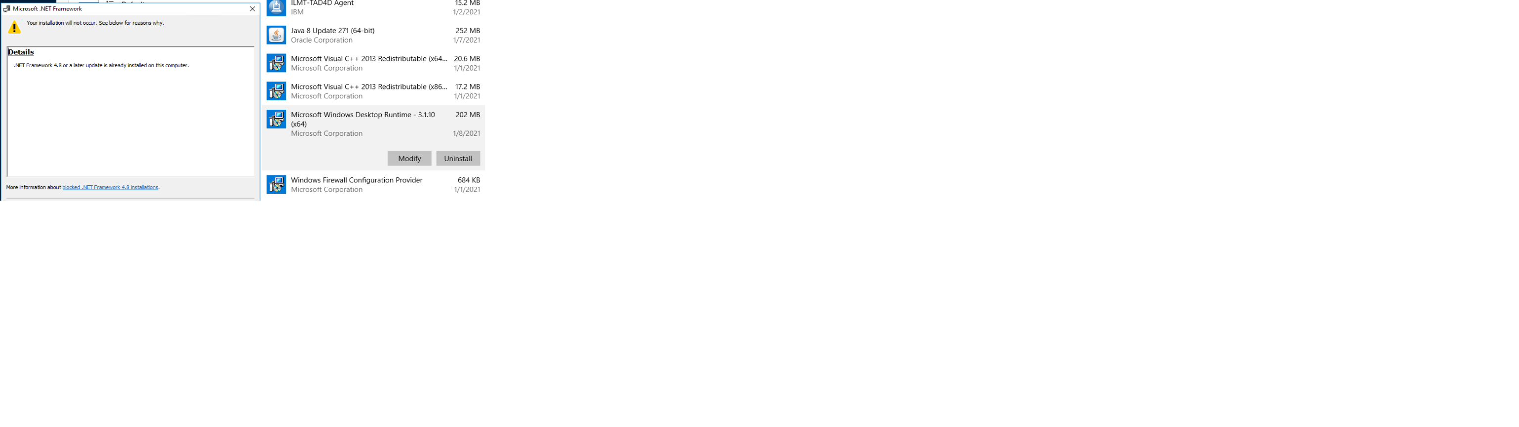

Rather than install .NET Core SDK, try .NET Core Runtime instead. Make sure to uninstall the SDK first too. You can download it via:
https://dotnet.microsoft.com/download/dotnet-core/thank-you/runtime-desktop-3.1.10-windows-x64-installer
Also, ensure you're using .NET Framework 4.8 via https://dotnet.microsoft.com/download/dotnet-framework/thank-you/net48-web-installer.

still the same error :(
uninstalled all .NET installations and choose the two you linked in the response. .NET framework allready installed as feature on the server.

Problem solved. I uninstalled .NET CORE 3.1.1 and installed 3.1.8. That solved the problem.
