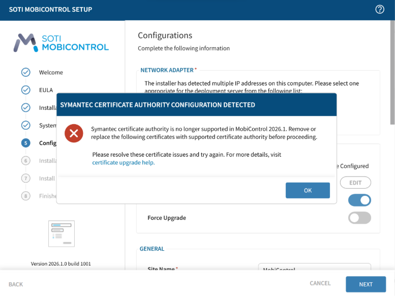

With the release of SOTI MobiControl v2026.1.0, support for Symantec Certificate Authority (CA) has been officially removed. To enforce this deprecation, the SOTI MobiControl installer validates each upgrade environment for the presence of Symantec CA configurations.
During the upgrade:
  • If Symantec CA references are detected, the installer will block the upgrade and display a pop-up message:
Exception shown in the installer indicating references to Semantic CA configuration
This validation ensures customers remove all Symantec CA dependencies before upgrading to v2026.1.0 or later.

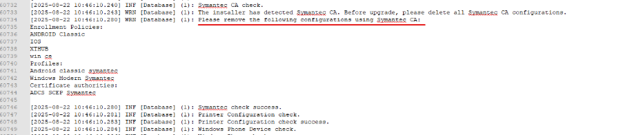

Step 1: Identify Symantec CA References
1. Navigate to the following path on your SOTI MobiControl server machine:
C:\ProgramData\SOTI\MobiControl\Installer\Log\Installation.log
Navigating to this file path: C:\ProgramData\SOTI\MobiControl\Installer\Log\Installation.log
2. Open the log file stored in this location.
3. Search the log file for "Symantec" entries.
Looking for Symantec entries in the log.
4. Copy the list of locations where Symantec CA is still in use. These references could appear in:
  • Profiles
  • Enrollment Policies
  • Certificate Authorities (CAs) in Global Settings
