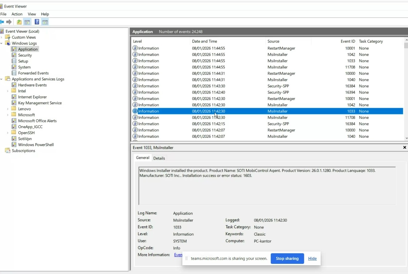

Although no explicit error appears in Event Viewer, the following informational event is logged:
Event ID 1033
Windows Installer installed the product. Product Name: SOTI MobiControl Agent. Product Version: 26.0.1.1280. Installation success or error status: 1603
Error code 1603 indicates a fatal Windows Installer error.
Event Viewer 1033
