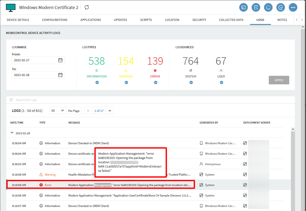

The application fails to install on the device with the following error:
Modern Application Management: "error 0x80190193: Opening the package from location ********-9ef4-11a5bf257a75?appKind=ModernEnterprise failed."
Windows Modern error
