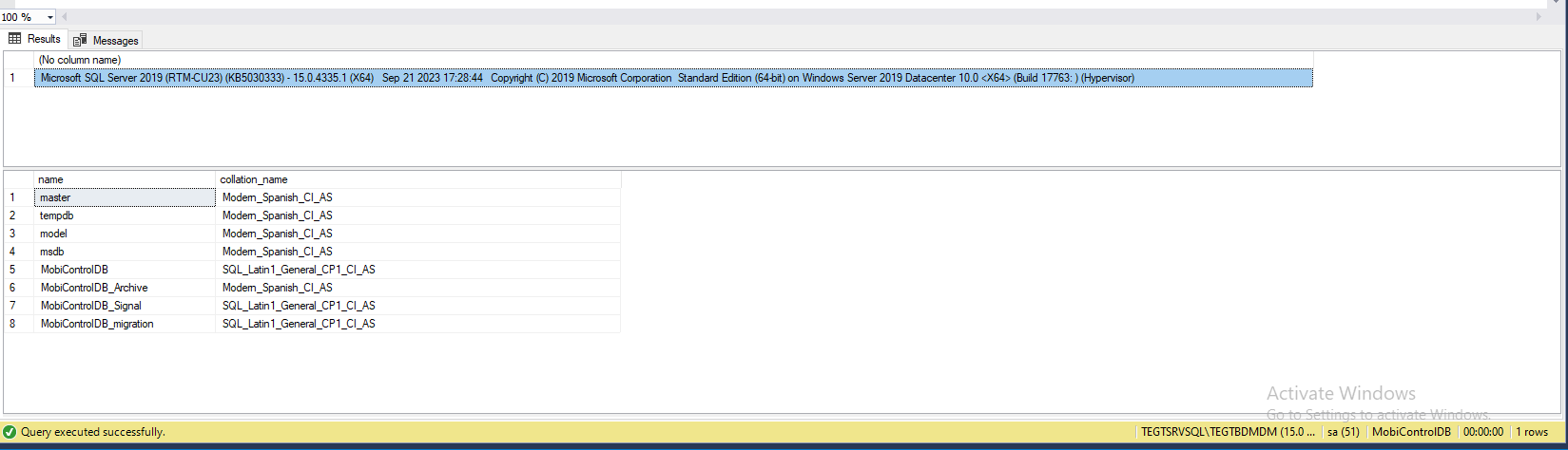

SQL query showing collations for different DBs.
Issue Resolution
In this particular case, the DB uses SQL_Latin1_General_CP1_CI_AS and will continue to use this collation, therefore the SQL Server should have the same.

Use the following query to identify the collation:
SELECT name, collation_name FROM sys.databases
