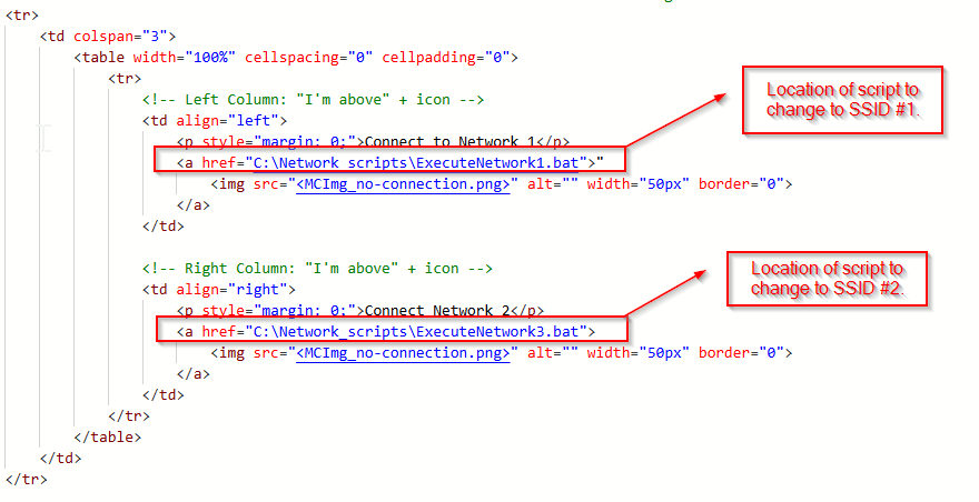

4. With both scripts on the computer, add the icons to the template and reference the script location. Below is an example of how to do this. If you modify the HTML template to include the icons and reference the script correctly, the result will be correct. After making these changes, apply the profile to the necessary devices.
Sample configuration of the Lockdown template, demonstrating how to point to the .bat scripts.

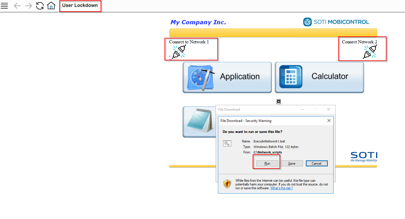

5. After the lockdown profile is applied, when the user selects the icon, a prompt to run the file may display. Select Run to execute the script and switch the device to the desired network.
Screenshot showing the Lockdown on the device, displaying the two created icons with a prompt to run the script.
