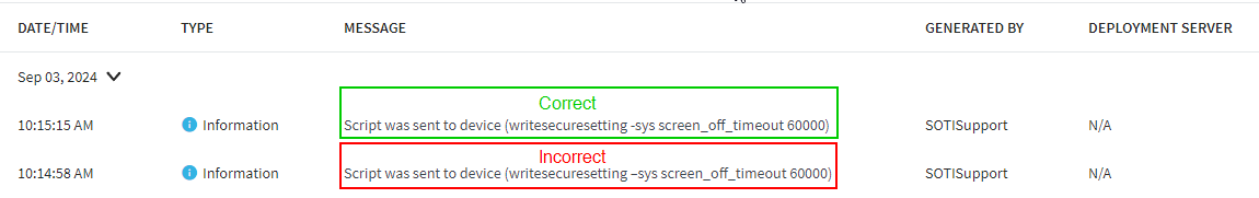

Example device logs for both a correct and incorrect script sent to the device:
