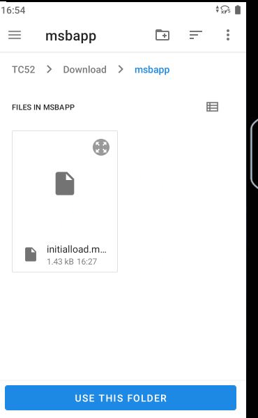

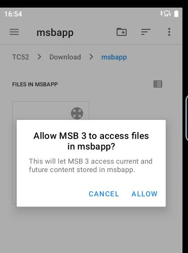

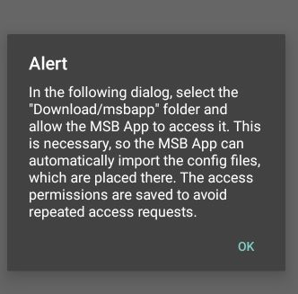

Goodmorning,
I'm able to import Mobisys profiles into android 11, but extra permissions are needed.
Does anyone know how to configurate the permissions trough an *.xml fille or file sync rule.
See attached pictures for the permissions which will be needed.

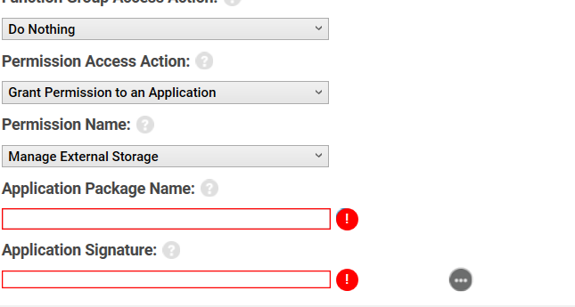

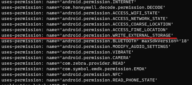

It looks like it is a Zebra TC52 so you can use MX XML to grant WRITE_EXTERNAL_STORAGE permission to the app. The process itself is a bit convoluted and advanced. You will need to create an MX XML in StageNow that provides this permission to your app. In order to build the MX you'll first need the app signature that you can get by running it through Zebra SigTools. Once you have the signature you can create an MX instruction in StageNow to grant the permission, export that XML, deploy to the device via Package (recommended) or File sync, and then process it using the mxconfig SOTI script.
https://developer.zebra.com/blog/generating-package-signature-use-mx

Unfortunately you only have the " manage" access inside Stagenow and not the "write" access

Hi Willem,
Can you tell me where you are seeing this issue? What section is this screenshot taken on StageNow?
