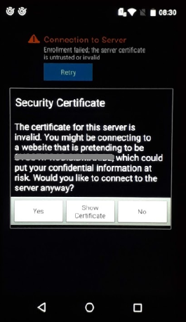

However, we still get a similar notification on the mobile devices in the device agent.
Our devices are enrolled as 'work managed device' into SOTI MobiControl, using the afw#mobicontrol 'google account'.
The notification appears when performing the enrollment, immediately after entering the enrollment URL in the MC app.
How can we get rid of this?

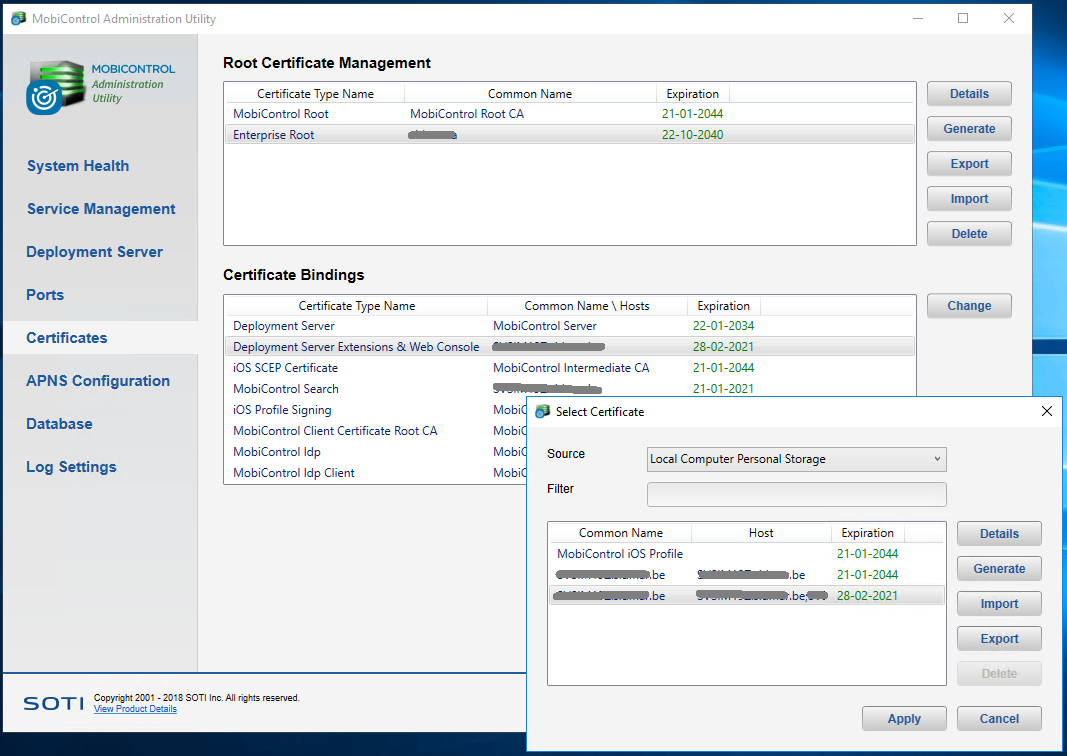

We imported our root certificate in MCAdmin, and then imported the certificate containing the computer name of the server in "Deployment Server Extensions & Web Console" (see screenshot below).
As for enrolling new devices: this still seems to work, but at a given point, I get the 'invalid certificate' warning on the device, which I would really like to get rid of...

As you are using your  private "computer name"  rather than a public FQDN in your self-signed certificate,  there is no way to validate that your server is actually the authentic server the agent is supposed to be communicating with. Hence, the warning you are concerned about is inevitable.
If your devices are for iOS and Windows 10 platform, they can't even be enrolled nor controlled any more when Apple and Microsoft has respectively tightened the certificate requirements for any enterprise-grade EMM.  I believe Google will eventually follow suit and won't allow any Android Enterprise devices to be enrolled to an MDM/EMM server without a strong third-party certificate from a reputable CA.
