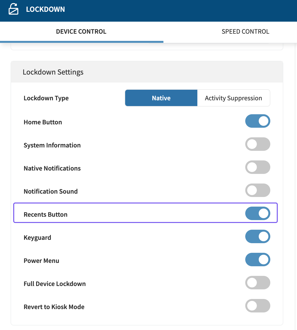

Is there a setting we can enable to toggle between open applications when we are utilizing and locking down to just certain applications?  We have a lock screen and allow access to six applications, but staff has expressed frustration that they can't toggle between allowed applications. An example would be Teams and our inventory control application.  In its current state, when you toggle to lose everything on the application that you toggled out of to another application.  We are utlizing Andriod and SOTI MobiControl.  Any help would be appreciated.  Thanks

If you are using the Native Mode lockdown you can configure it so that the Recents button is enabled which will give users access to the app switcher to toggle between open applications.

Thank You Matt, could you provide where this setting would be located?
2 years ago
It's under the Lockdown configuration settings. Note that your devices need to be on Android 9 or higher for it to work.
