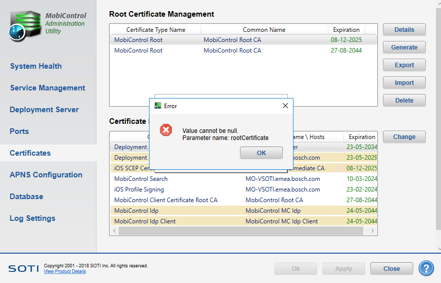

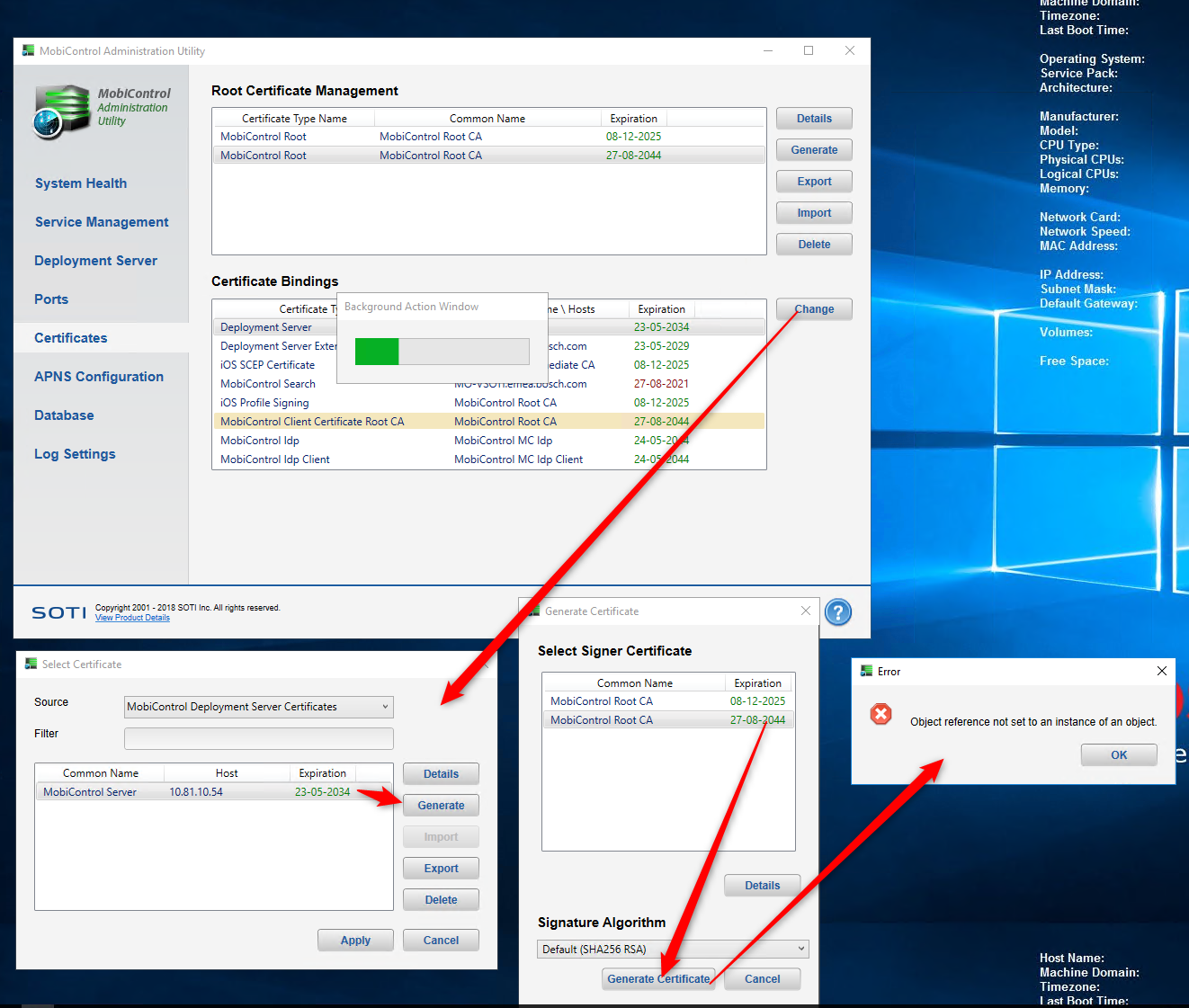

We had previously SHA1 certificate on this server because there was also several Windows CE devices. This is not anymore the case, we have only Android devices connected to this DS. Problems happens when i try to generate SHA256 certificate to the Deployment Server (and all others) from the new SHA256 root certificate generated 2 years ago. Same case with freshly generated root certificate. This fails (Message of type NullReferenceException).
Procedure : in MCAdmin Utility, i clicked on the SHA256 root certificate, clicked on Deployment Server in the Certificate Bindings list, and then "Change" button, then i clicked on "Generate" on the Select Certificate window, and then selected the SHA256 Root CA and "Generate Certificate" and it fails  (Message of type NullReferenceException).

As a precision, all devices with Android 8.1 are connected with success, i updated just one TC52 to Android 11 and i got a SSL Negociation failed error
Steps in MCAdmin :

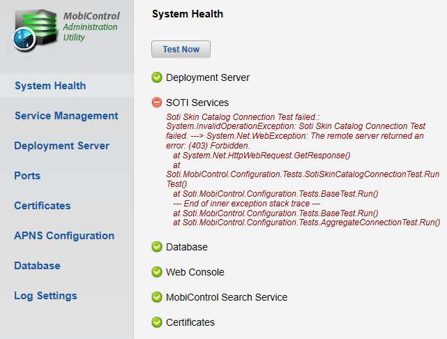

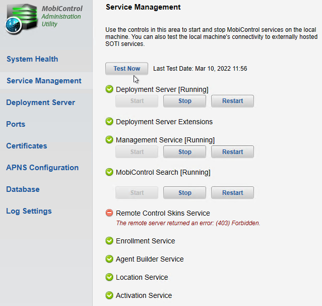

fyi, the connection is open only to following hosts :
  • activate2.soti.net
  • mc-enroll.soti.net
  • mobicontrolservices.soti.net
  • location.soti.net
  • location2.soti.net
  • skins.soti.net
Below, you can find the status of the server, only skins part is missing, but not important for the certificate renewal process.
But also, when I try to regenerate a Root Certificate, i get this error :
But it's generated, i've been able to put SHA256 certificates for the DSE&Web Console part, but not the DS part. The DS service would not start (in the Event Log there was an error saying that the certificate has no private key).

Hello Fabien,
can you check on your MobiControl Server if the Services are running:
Soti Remote Control Service
Soti Assist Services (if installed) for only using the WEB Remote you do not have to buy it.
Yoi can have alook into the Logs if there are any other Error Messages: C:\ProgramData\SOTI\ on the Server.
