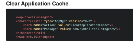

wipeapplication isnt going to work as that feature isn't supported on AEDO managed Zebra devices in SOTI. You can however use Zebra MX configuration to accomplish what you're looking for. You can create a StageNow profile with the AppMgr CSP set to clear the app cache of the app in question. Then export that StageNow profile as an XML file and deliver it to your devices via Package. Then when you want to execute that action you can send the script mxconfig /sdcard/yourfile.xml and it will perform that action. The XML file will have the following sample format.
If you don't want to, or know how to, go through the StageNow process then you can just use the following XML snippet saved as an XML file and then load that onto the device via Package or File Sync.
  <wap-provisioningdoc>
    <characteristic type="AppMgr" version="8.0" >
        <parm name="Action" value="ClearApplicationCache"/>
        <parm name="Package" value="com.google.android.googlequicksearchbox"/>
    </characteristic>
    </wap-provisioningdoc>
