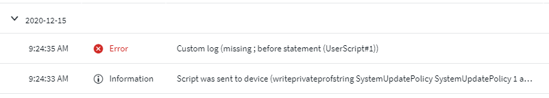

In the log I get the error Custom log (missing ; before statement (Auto Update OS.js#1))
My Auto Update OS.js is just
writeprivateprofstring SystemUpdatePolicy SystemUpdatePolicy 1
apply SystemUpdatePolicy
If I open send script on a device,select JavaScript and send the same script above I get the same error.
If I select legacy I get the notifications.
Script was sent to device (writeprivateprofstring SystemUpdatePolicy SystemUpdatePolicy 1 apply SystemUpdatePolicy
Feature is not supported (SystemUpdatePolicy)

This is the error i receive if i run the script on a device
