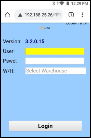

Can anyone advise how I get the page to display correctly AND with no address bar
Chrome v76.0.3809.132
MobiControl v14.3.4.1087
Hardware Honeywell Android 8.1.0, build 86.00.13-(0108)

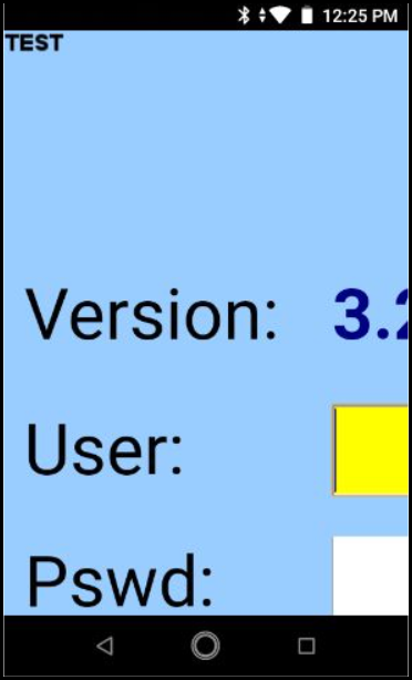

Using https://myurl#Intent;scheme=http;action=android.intent.action.VIEW;component=com.android.chrome/
I get no address bar BUT the page has zoomed in:
So, I tried browsers://myurl#Intent;scheme=http;action=android.intent.action.VIEW;component=com.android.chrome/
I now get the address bar, but the page displays as I want it to.
Tried using intent:https://myurl#Intent;scheme=http;action=android.intent.action.VIEW;component=com.android.chrome/ out of curiosity, but the button on the kiosk page doesn’t do anything when pressed.

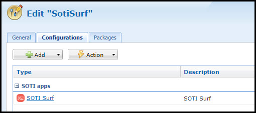

Have gone down the Surf path and have hit a snag with it.

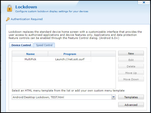

I have added Launch://net.soti.surf as a lockdown item via profile
I have created a different profile for Surf settings. I need to enable home page, as EACH device requires a different URL i.e. https://myurl=HHxx where xx is a 2 digit number)
My problem is that when I select icon on the kiosk page, nothing happens. If I exit kiosk mode, I can launch Surf and browse to the URL. But I can't via the kiosk?? It was working for a while, but then nothing (I did add the WMS logo to the server and assign to the lockdown item - cant be that, can it?)

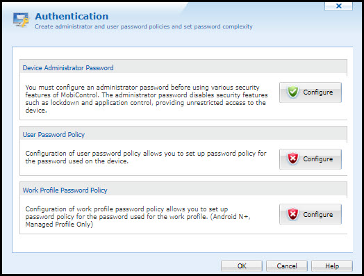

You need to make sure
1. you have deployed authentication payload with "device administrator password" configured

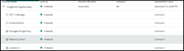

2. the status of both profiles containing the kiosk and Soti Surf payloads are "installed"
   [Bhav] Yes, done
[Bhav] Everything showing as installed

I figured out why I couldn't get the icon to work. I forgot that in the template, I had changed the MCLink0 value to a custom value previously <insert facepalm>.
