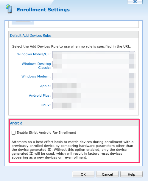

Try enabling this option under Global Settings.

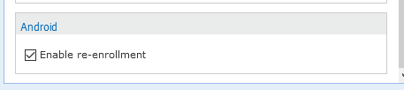

The version we are using looks a little different, but this option is already checked.
You may want to consider upgrading then. I have not seen this issue happening on newer versions with that option enabled. We run 15.2 in most environments now.
