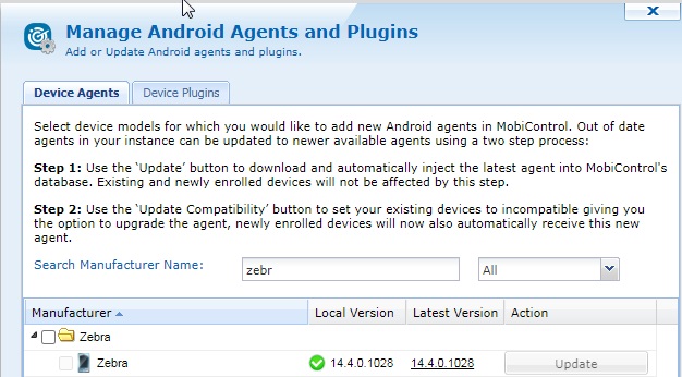

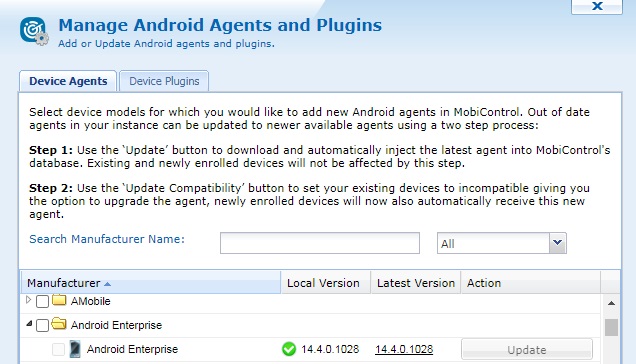

Hi, i'm installing TC51 in our new Soti now and saw this "problem":
In Soti are following Agents:
But the installed Version during enrollment is 14.3.2.1050.
I can Update via Playstore to 14.4.0.1028 manually but why doesn't it install the newest Version by default and why do i have to update it manually?

The initial pictures you've referenced is the Android Agent Delivery Service, this function ultimately serves to efficiently manage your Android Classic agents, which is also known as OEM Specific. Now regarding Android Enterprise, the best practice is to upgrade your agents via a Managed App Catalog.
This firstly requires an Android Enterprise Binding and your device will need to have the binding selected within the Add Device Rule on enrollment. Or alternatively use the "Reset Account" function introduced in MobiControl v15.1 to dynamically assign the enterprise binding to the existing devices.
The Android Enterprise agent found within the "Manage Android Agents & Plugins" is similar to a placeholder and does not serve the function you believe it does. Ultimately upgrade your AE agents via the Managed App Catalog.

And as i posted in screenshots, the agent is the newest one for this brand and for AE.
The default agent version for each OEM device brand/series  is global for the WHOLE server implementation, and NOT configurable on a per add-devices-rule basis.
R
Rafael
So, i don't understand your previous post:
"it is always the administrator who make the call which agent version to be configured as the default."
As you see in the screenshots the newest agent is set as the default (i understand it so) but isn't used. And thats my problem.

Check your StageNow configurations to see if your existing barcode specify a different device agent source and/or agent version.  If so, make proper change(s) to generate a new barcode for enrollment.

It is true since MobiControl v12/13 that the AE device agent of an enrolled device can be upgraded to the agent version availalbe on Managed Google Play store with an app-catalog rule.  However, your problem is related to device agent initially installed upon enrollment.  The limitation of this path is that there is only one active (i.e. the latest) agent version available on MGP store, but older device hardware/firmware sometimes work better with older device agent .
The "Manage Android Agents and Plugins"  function is nothing more than a simplified GUI to install DEFAULT device agent for a particular brand/series/model (whatever applicable for that plugin), without the need to do manual injection of device agent and configuration in the MS-SQL database tables.   Once an AE enrollment method chosen, and enrollment parameters & add-devices rule are both properly set up to make the device download its agent from your MobiControl server, the corresponding DEFAULT device agent will then be downloaded.
