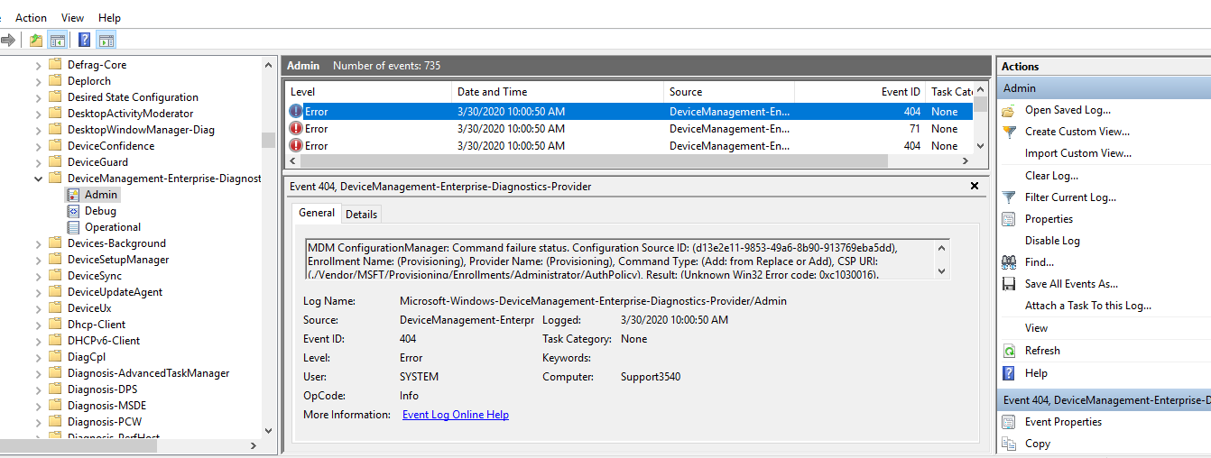

I am receiving the following error when trying to enroll a Windows 10 device into our test MobiControl environement
What should I do?
MDM Enroll: Server Returned Fault/Code/Subcode/Value=(a:InternalServiceFault) Fault/Reason/Text=(The server was unable to process the request due to an internal error.  For more information about the error, either turn on IncludeExceptionDetailInFaults (either from ServiceBehaviorAttribute or from the <serviceDebug> configuration behavior) on the server in order to send the exception information back to the client, or turn on tracing as per the Microsoft .NET Framework SDK documentation and inspect the server trace logs.).

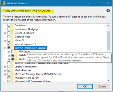

  1. Write in the windows search bar “Turn Windows features on or off”
  1. Select Internet Information Services (IIS) and apply the changes
  1. Execute the Internet Information Service (IIS) Manager

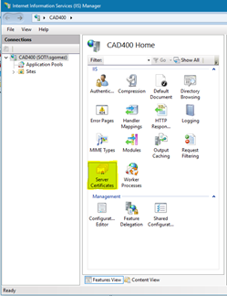

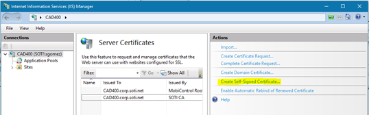

IIS (Internet Information Server) is a web server from Microsoft that is used to host your Web application. IIS has it's own Process Engine to handle the request. When a request comes from a client to the server, IIS takes that request, processes it, and sends a response back to the clients.
Creating a Self-Signed Certificate
  1. Click on Server Certificates
  1. Click on “Create Self-Signed Certificate”
  1. Specifying a certificate name and type
  1. Checking details: Right-click on the certificate and click on View, then confirm Details
Scroll to the bottom of the window and copy the “Thumbprint” in a notepad For this case was d********************************65d

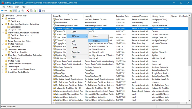

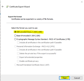

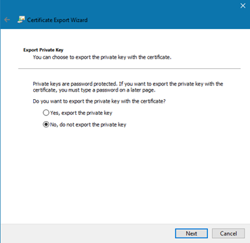

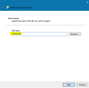

It will be necessary for our Self-Signed Certificate in two flavours or forms. As a .cer file to be uploaded at MobiControl Web Console enrollment rule for Windows and .pfx

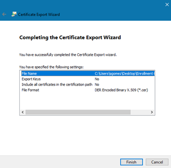

Exporting as .cer

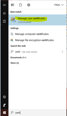

  1. Open the Manage User Certificates on the Mobicontrol Server
  1. Right-click over the Self-Signed Certificate > All Task > Export…
  1. Select “Do not export the private key”
  1. Select DER encoded binary X.509 (.CER)

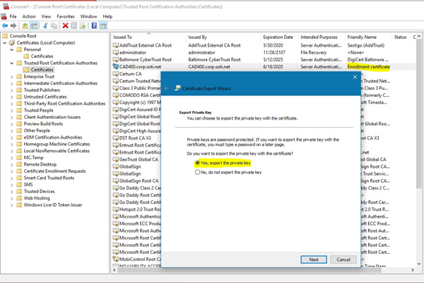

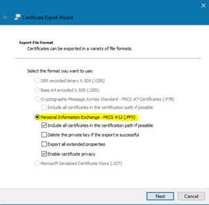

Exporting the Self-Signed Certificate as .pfx to be used with the Windows Configuration Designer

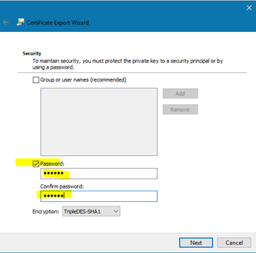

  1. Export the self-signed certificate including the private key. Using the same instructions to export the certificate but this time exporting the private
  1. Select .PFX
  1. Select to use a Password. In this case, it was 123456 but could be anything else (more than 6 characters).
  1. The encryption method for password could be altered. Please note this encryption is different than what is used for the certificate signature algorithm (SHA256RSA, check 4)

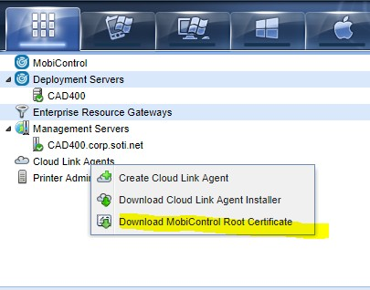

Getting the Root Certificate
  1. Get the MobiControl Root Certificate from the web console.
Click on Global Settings > Right-click on “Cloud Link Agents”
Be sure to remember the location (folder) where you export both .cer and .pfx certificates and Root certificate. You will need it soon.

I would just like to share my findings.
I could not download the root certificate from here anymore.
I use MobiControl 15.4, and there it can be found in the Windows Modern Add Device rule, in the tab [Rule Target]

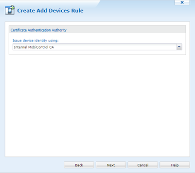

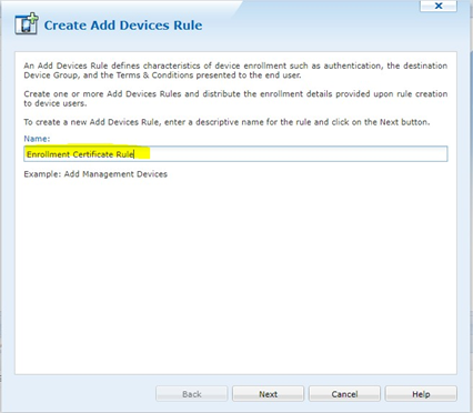

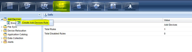

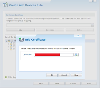

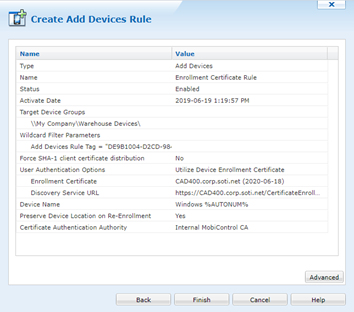

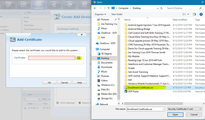

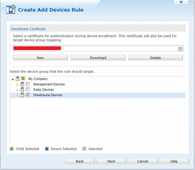

Creating the Bulk enrollment rule at MobiControl web Console
  1. Select Global Setting, click on Windows > Right-Click on Add Devices > Click on Create Add Devices
  1. Assign a rule name

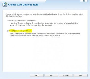

  1. Choose Certificate Based Enrollment
  1. Importing the .cer self-signed certificate and add this certificate
  1. Select the target device group and add devices rule
  1. Finish the bulk enrollment rule

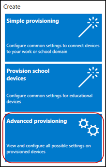

Creating a Configuration Package
Objective: Create an enrollment package using Windows Configuration Designer.

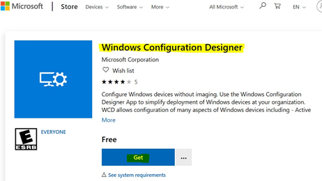

Install the Windows Configuration Designer onto your computer from the Microsoft Store.
  1. Download and install it, then click on Advanced Provisioning
  1. Enter a project name and click
  2. Select All Windows editions, since Provisioning CSP is common to all Windows 10 editions, then click Next.

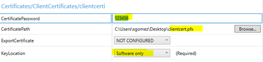

  1. Importing the Client Certificate (self-signed generated certificate)
Once the above Workplace settings are configured, the next step is to add ClientCertificate
Click on Certificates > ClientCertificates
  1. Assign a name for client certificate
  1. CertificatePassword, use the same password used to export the self-signed
  1. CertificatePath, Introduce the path of the .pfx certificate
  1. Choose the KeyLocation to be Software only. Final settings appearance:

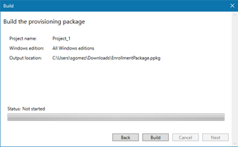

Exporting the provisioning Package for Bulk Enrollment

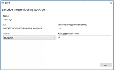

  1. On the top of the Windows Configuration Designer, click Export > Provisioning package
  1. Enter the values for your package and specify the package output
  1. There is no need to encrypt the package as the enrollment process should be seamless on the device
  1. Select the location where you want to save your provision package and click Build.

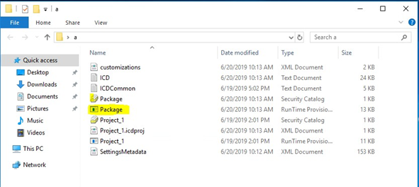

  1. Log in a Windows 10 device and copy the provisioning package (folder obtained with the steps about).
  1. Open that folder and double-click on the .ppkg file (for this case ppkg).

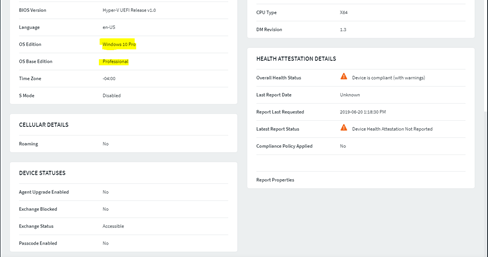

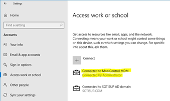

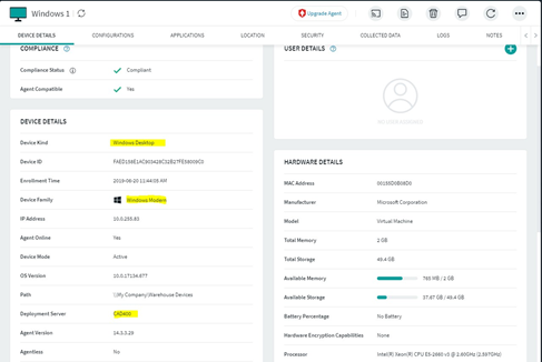

  1. Confirm the success enrollment at the Windows 10 device looking at Windows Settings > Accounts > Access work

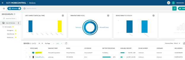

  1. Check-out on MobiControl Web Console the enrolled device

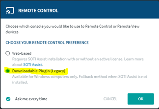

  1. Use the Legacy Option for device remote control

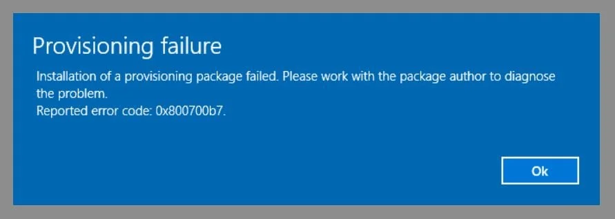

I've gone through all the steps that you have listed, and it is still not working.
I receive the below error message when I attempt to deploy the provisioning package that I built
Any suggestions on what I can try next?

Looks like there is a mismatch of certificates. We need the DSE logs to troubleshoot further and check the certificates in the rule and the package. So, can you please raise a support ticket(Click here) or call +1 905.624.9828 to assist you on this, as we need more details to troubleshoot further?

I'm trying to enroll a Windows 10 (1909) device with certificates generated on my server running Windows Server 2016 Standard.
I follow step by step all the indications for two times without any error but when I execute the .ppkg, Windows reported me an error:
I'm using Mobicontrol 15.
In my Event Visor I can see the same information that Evan (the OP).

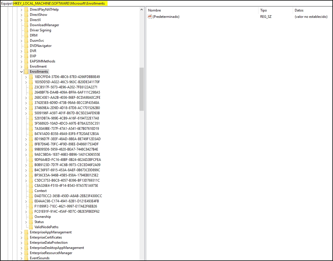

JB
Jeff Burns
I had the same issue. Here is how I resolved:
  • Open Regedit.
  • Navigate to "HKLM\Software\Microsoft\Enrollments".
  • Change the value of "ExternallyManaged" from 1 to 0.
Close Registry, remove any previous provisioning packages and attempt to install again.
DF
Dani Fernandez
Hello Jeff.
I don't see 'ExternallyManaged' in my Regedit. I searched this value but it isn't registered:
JB
Jeff Burns
Guessing that's not what is causing your issue than.
What is included in your ppkg file? Is it just the settings for enrollment?  If it's not I would recreate the provisioning package and keep it as minimum as possible, only settings for enrollment.  Some settings can only be applied during imaging the device and throw the provisioning error if just ran in the os and fails.
Always make sure you're removing the previous provisioning package before installing a new one.
Hope you have some luck.

I'm hijacking this dead thread, because many people are still using this as a reference for how to create the SOTI Provisioning Package for Windows Modern.
First, SHA1 is not required anymore, nor is it possible to create these types of certificates through modern versions of IIS, the only option is now SHA256, and the ability to choose this type has been removed.
Separately, PowerShell can now generate client certificate automatically, in modern versions of Windows 10. This takes all of 2 seconds to do the thing, instead of all these steps to install IIS on your workstation to do it. I have included my script below, which you can customize to your taste. This has been tested and is working on 15.5.
