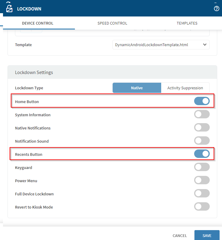

If the Buttons option was selected in the device settings, then can you please check in your lockdown profile if is it selected as Native or Activity Suppression?
If it is selected as Native lockdown, you have options to enable Home Button and Recent Button in the lockdown.
Please, check the attached screenshot for more details.

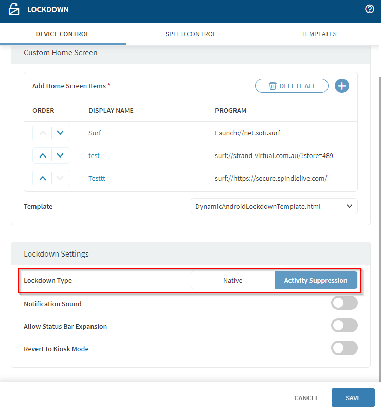

If you want to display the battery percentage in lockdown, you can select lockdown type as activity suppression and you will see the battery percentage in lockdown mode.

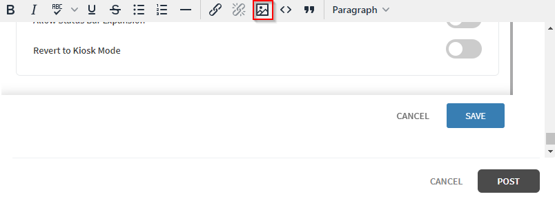

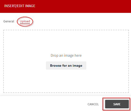

For attaching screenshots to post, I have attached some screenshots here, please have a look, it will explain to you the steps of uploading pictures to the post.
