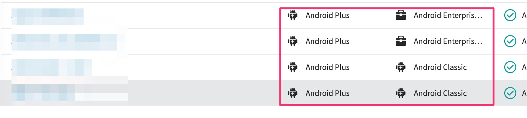

I have not seen behavior like that before, where an existing WiFi configuration prevents the configuration of a new configuration. Are you adding the proxy to a configuration for the same existing SSID that the device is already configured for or connected to, or is it a new SSID?
Also you mention Andoid Plus, but can you confirm that the Type is Android Enterprise. Confusingly both Classic (DA) and Android Enterprise Work Managed (DO) both show as Android Plus Family, but are differentiated by type. It is probably correct if it has installed on some devices and is even showing pending status on others, but still worth verifying that you have the right Profile Type.

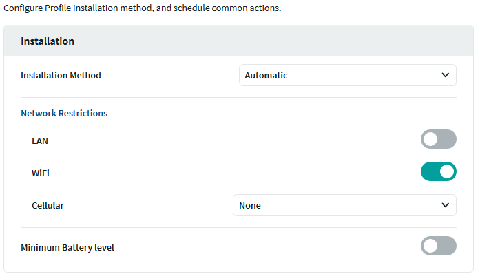

Also check to see you don't have any network restrictions in the Profile installation criteria:

Matt,
Thank you so much! This was it. Sorry I missed this. Something I should always keep in mind now.
Appreciate the hint.
