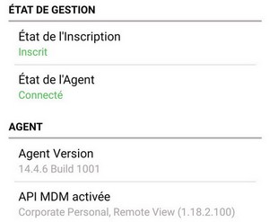

To confirm which model your device has been enrolled into, you can check the active MDM API's reported in the configuration tab of the device agent or from the device information tab in your web console.

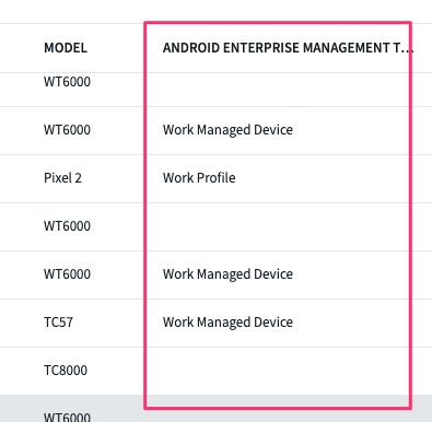

Can you add the Android Enterprise Management type column to your inventory view and then provide us with a screenshot of what you see so that we can get a better idea of how each device is being managed?

Hello, Matt,
Here below. The "Mobiwire" manufacturer is actually cipherlab, not sure why it's wrong.
