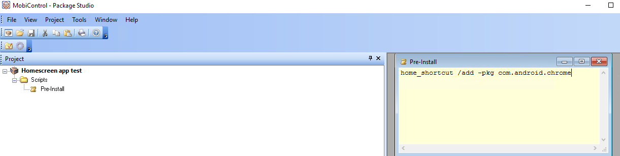

I've tried a post-install script and pre-install but it didn't worked (note that the package is checked as automatic installation). App gets installed but not on the main screen (only apps screen). We've created a catalog previously for other devices but it also pushed the apps in the app screen.

Daniel_Infra
I've created a package containing that script then pushed it as a profile. It didn't put the chrome app on the main screen. Neither sending the script directly to the mobile on the device details.

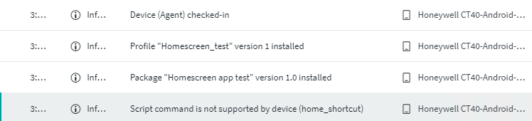

The profile gets installed but seems that the script isn't support on the device. There's no error message in the logs

JVMOD@SOTI
Hello Daniel,
Thank you for your response, unfortunately your device doesn't support the script we have.
For now only option available is to do it manually. I will try to reach out to Product Management team  to know if there is any restriction from OEM side or our side.
