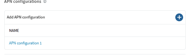

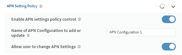

Hello there,
I recently upgraded to Mobicontrol Version: 2024.0.1.1020 - after upgrade mobicontrol no longer supports native APN atleast not on my envoirement in the documentation it states that the profile does not work on MAPI-enrolled devices however all my devices are not enrolled in this way, yet the profile is not supported.
So I am thinking about configure this APN setting using KSP, but without luck.
Is it because the name here is wrong, the name defined has 2 different names.
1 in the overview and 1 inside the APN configuration.
Does anybody how to make this work?
