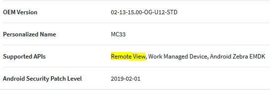

I have enrolled an Zebra MC33 Oreo (with latest Lifeguard Update) device with Android Enterprise Device Owner.
The Hawkeye Plugin available from Soti Webpage was installed via MobiControl and shows up as "installed".
The problem is that there is only "remote view" available, remote control does not work.
Does anybody have an idea what the problem could be?

Same error here.
works fine on a MC93, but not on MC33

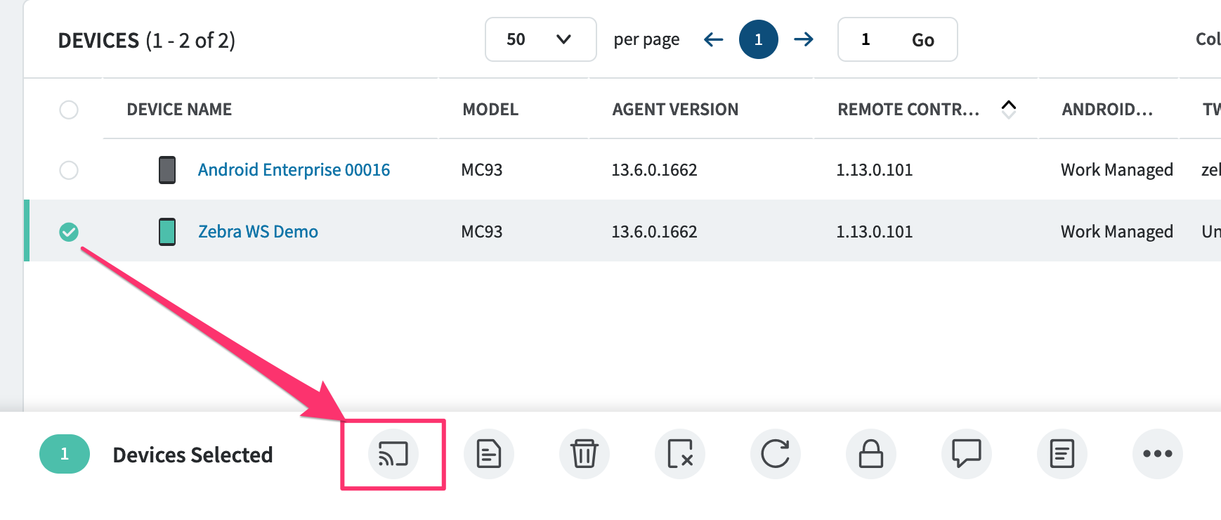

where can I get the remote agent (plugin) in V1.13 ??
Only the V1.12 is on the website.
