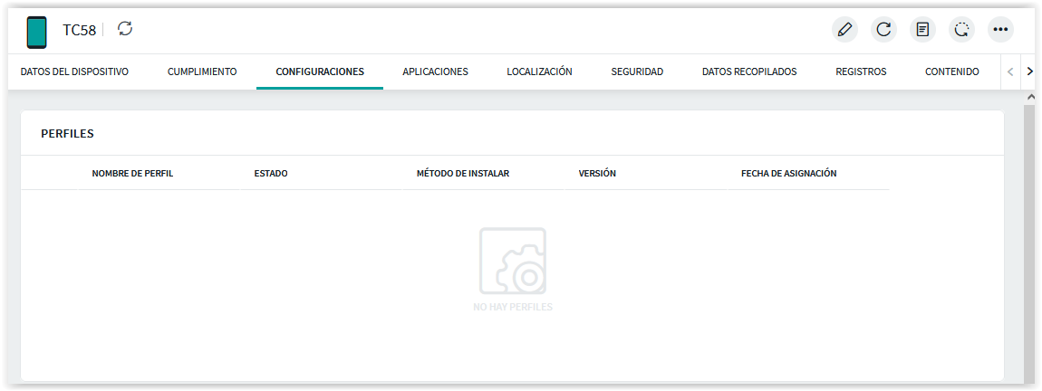

The second problem is related to remote control. Right after enrollment, neither the remote view nor remote control appears. In the image, you can see that it doesn't load the profiles, and the remote control is not visible. Compatible APIs also do not appear on the device information tab.

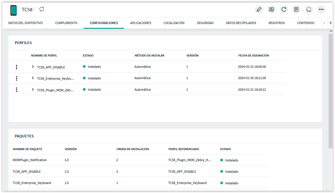

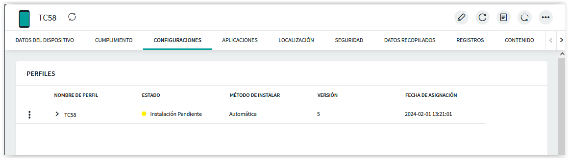

Now I enable the Android Plus profile with the Zebra plugin in the same folder, and the profile appears and installs:
Once the plugin is installed, the profile and the plugin are automatically uninstalled, and the Android Enterprise Work Managed profiles now appear. The Remote View also becomes visible:
