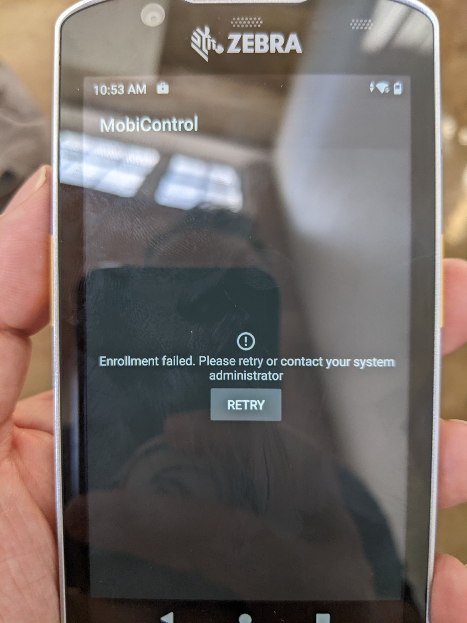

We're moving from windows mobile to android.
I created the default enrollment profile and have connected
the TC52 Android 8.1 to it successfully.
When I try to enroll a TC52 Android 10 devices it fails.

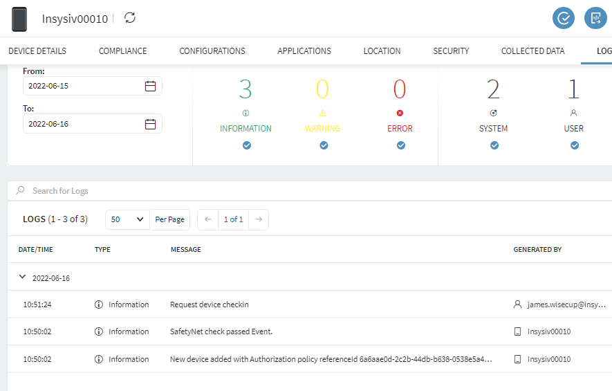

I can see it in MobiControl webconsole logs that shows it being added.
Any idea what is different for enrollment for a  version 8.1  vs  10 ?

Just got a reply back from soti supp...
"I have reviewed your server and see that the Deployment server is currently using a SHA-1 certificate. Android devices using OS 10 and above now require a SHA-2 certificate to be enrolled onto the server."
https://www.soti.net/mc/help/v15.5/en/console/devices/managing/enrollment/sha_1_sha_2_config.html

- We are using the Android Stage Programmer and scan the QR code at device initial startup.
- MobiControl is cloud hosted with Soti.
