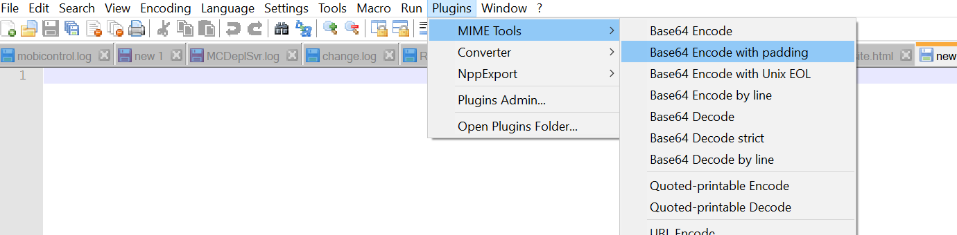

1. Not converting the Client ID and Client secret to correct RFC2045 MIME Base64 - How do we do this? I'm using notepad++ MIME Tools to convert. Is this correct? or am I doing it wrong?

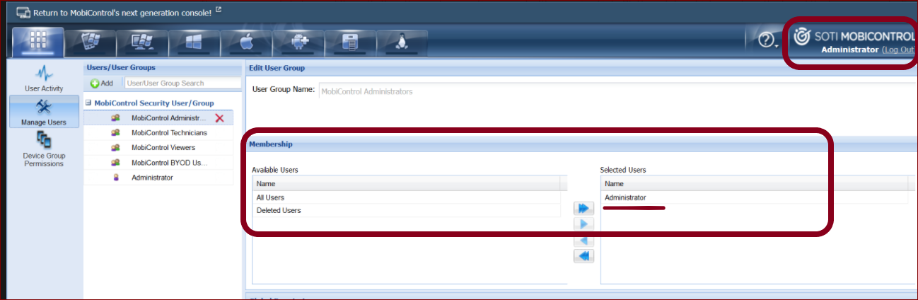

Can you please check if you are using a Mobicontrol user with Administrator privileges and It should be a Mobicontrol user not an Identity User. Please follow the steps below to check Admin User for your Mobicontrol account.
Kindly login to the Mobicontrol and Navigate to the Security Tab and look for your username and check if has the Administrator user group assigned to it under the Member section.

I have the user configured in the same way

Please use Base 64 encode with Padding for Authorization Key. Open Notepad++ in the Plugins > MIME Tools > Base64 Encode with Padding.
Then, Enter the word basic and then a space followed by the Base64 value from the last step. This would be the value for the Authorization key.

Unfortunately I did that too. I guess the problem is with the way I'm sending the Grant Type
