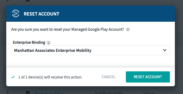

That would have been out of sequence then. The devices would have needed to enroll into the server with an Enrollment Rule that was associated with the Enterprise Binding so that they could get Managed Play service accounts assigned at enrollment. If you did add the Enterprise Binding until post enrollment then you obviously would not have been able to enroll the devices under that Binding.
You can factory reset the devices and re-enroll with an updated Enrollment Rule that has an association with that Enterprise Binding.
Alternatively, you might be able to retroactively add the account to a device with the Reset Account device action. This is a newer feature that I haven't had to use personally yet so I can't speak to its effectiveness.

After having enrolled the device is when I've done the "Android Enterprise Bindings" as I didn't know that was a feature I would have wanted / needed.
AP
Andrew Phelps
Many thanks Matt :-)
The reset account worked :-D
