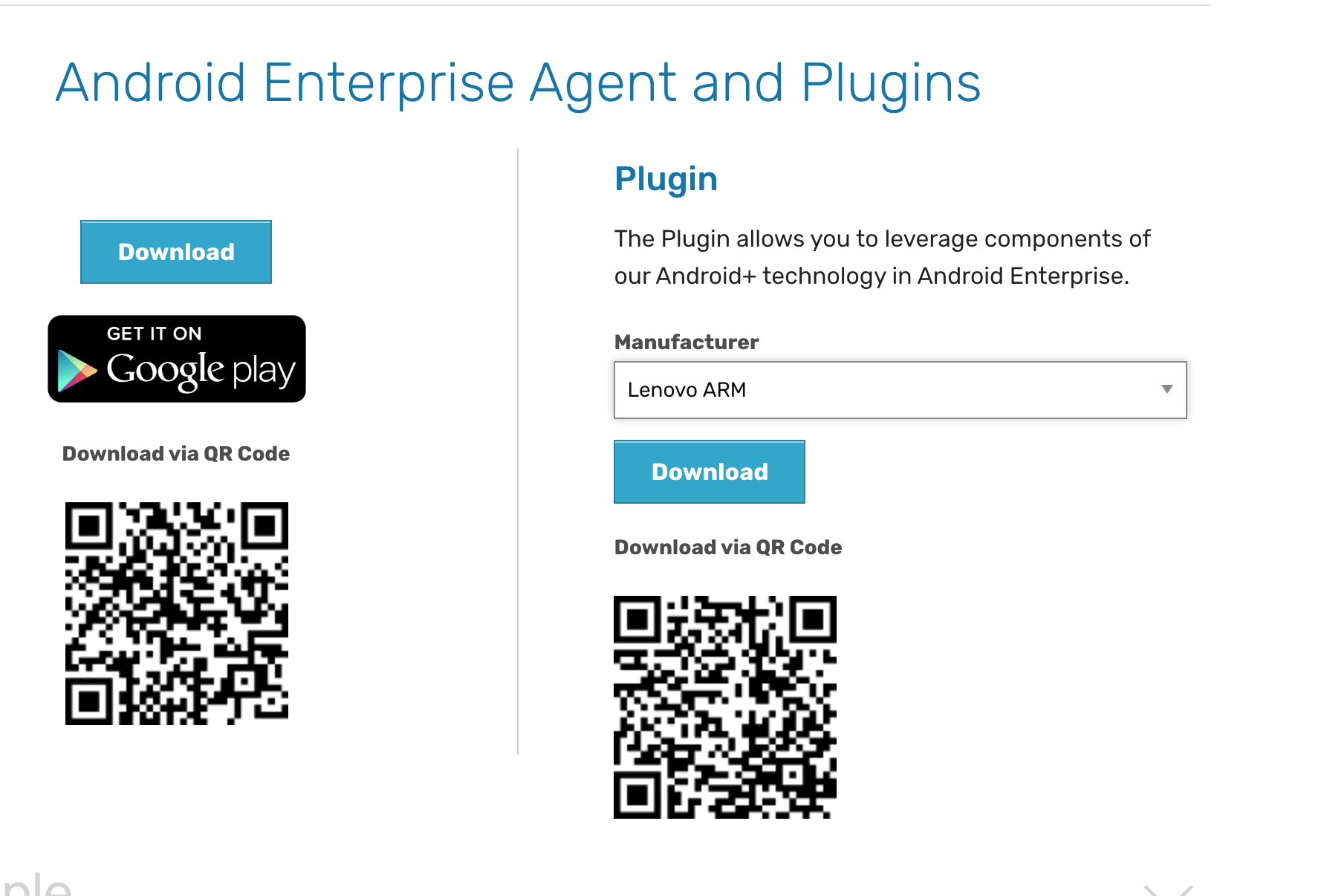

Got it. Speaking generically, support for writesecuresetting is coming around to AEDO in SOTI. At present it appears that you still have to manually grant the SOTI agent permission to be able to configure those settings, but it appears we will also get the granted automatically soon through the usage of the manufacturer specific plugins. This means that support for that capability may be limited by what effort SOTI is putting behind that particular manufacturer's device under AE
https://discussions.soti.net/thread/how-to-accept-write-settings-permission-programatically/
I just checked and their are Lenovo AE plugins available:
