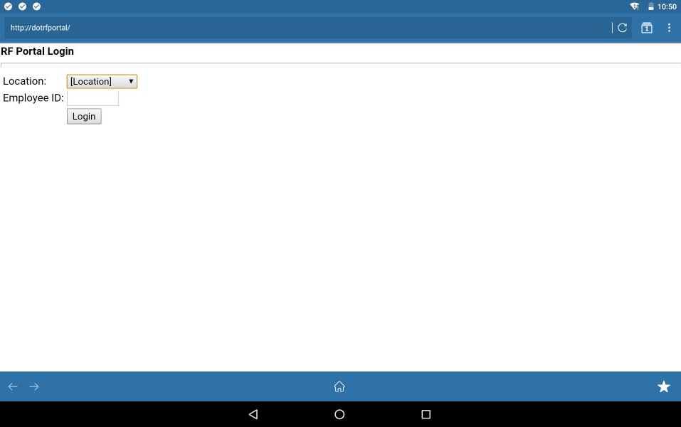

I was wanting to know if it's possible to disable the bottom bar only in the SOTI Surf browser version 15.3.1.7. Our end users keep hitting the back button on accident when trying to click a webpage button in the bottom left hand corner. So I was hoping there is away to either disable the bottom bar or even just the back button to prevent this from happening. I have tried using kiosk mode, but this makes it impossible for our end users to switch tabs. We are running MobiControl version 15.3.

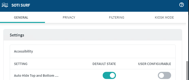

Kindly confirm if you have tried to use the accessibility settings  in soti surf configuration though not sure if you want to use that as  it provides you an options for hiding both bottom and top bar collectivily while in kiosk mode , you can hide bottom bar only.
Kindly let me know if it works for you or not.
