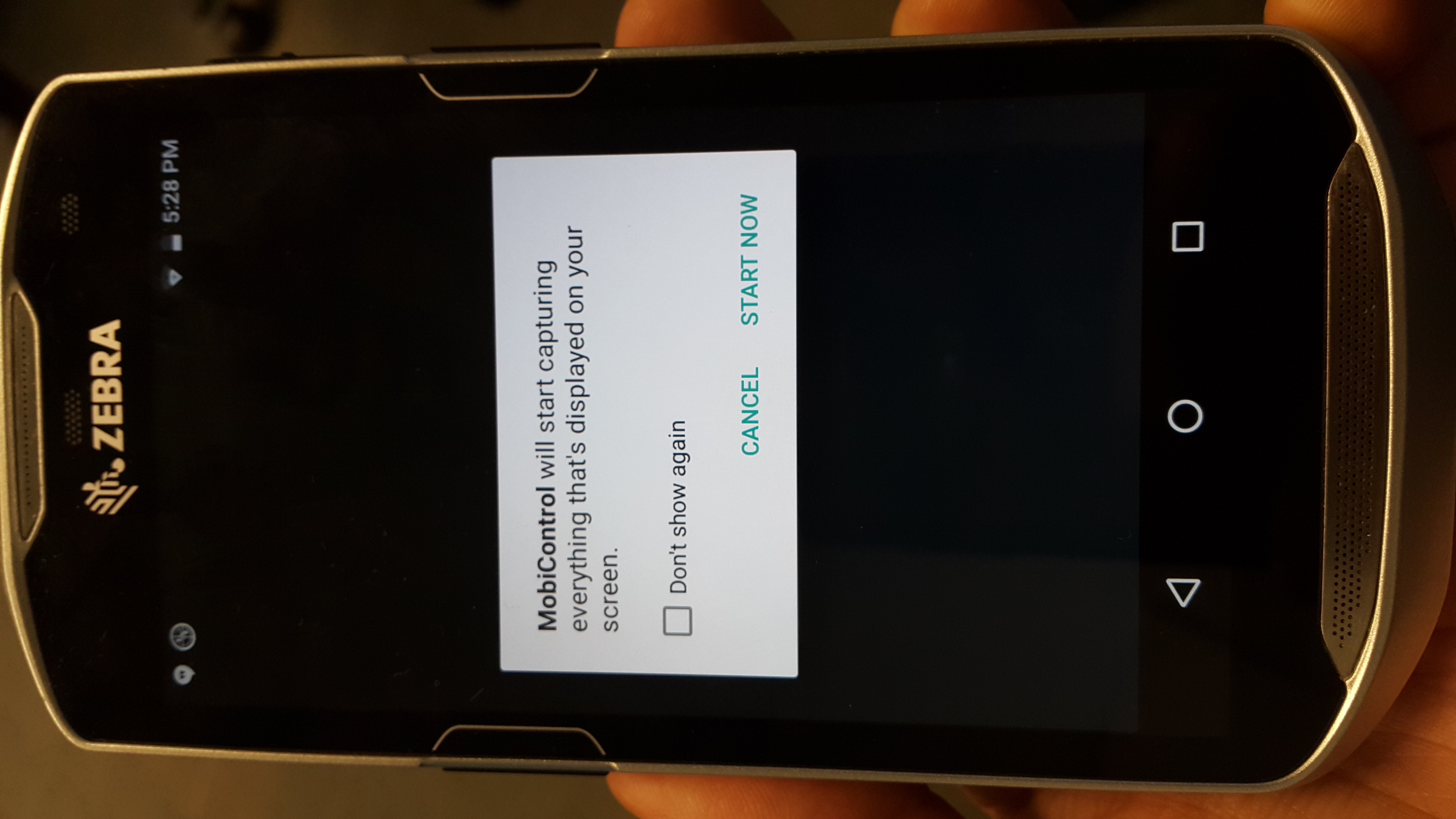

What behavior did you experience when using either of the remote options Legacy or Hawkeye?
Feel free to put up screenshots if you took any.  Does your device have a screen like this after initiating a remote session?
Zebra TC remote

Hi
Yes this seems to solve the problem. Thanks
