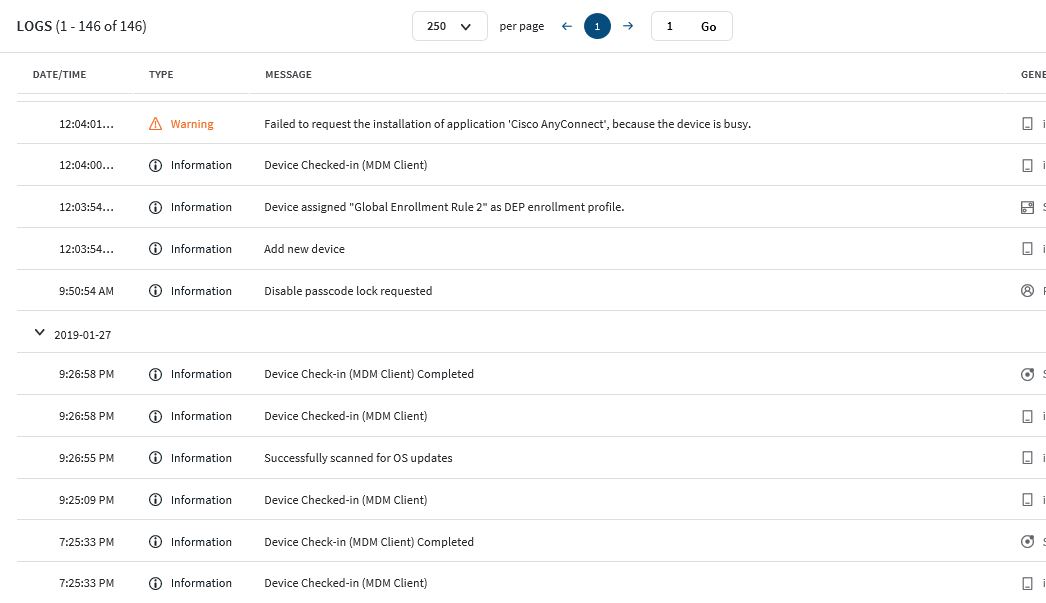

Problems occur across all platforms.  I have seen 11.2.2 up to 12.1.3 not check in and end up requiring a factory reset.  Even a check-in command will not be processed.  As you can see in the screen shot below.  January 27, last check-in is at 9:26 pm.   Device still hadn't checked in next day which required a factory reset.  I would like to prevent this and see if there is a way to enable the device to check in.  I have tried force restarting the device with Power & Volume down.  This will very rarely rectify the problem.  Any possible solutions would be greatly appreciated.
    Check-in Log Capture
As such varied spectrum of your devices are affected,  your inputs have steered me towards a totally different direction.   Maybe you can try enlarging the request message buffer size with following steps and see if there is any improvement:
1.  Open Registry Editor on your MobiControl server, navigate to HKEY_LOCAL_MACHINE\SYSTEM\CurrentControlSet\Services\HTTP\Parameters
2.  Create a new registry, right click on Parameters and select NEW - > DWORD
3.  Set "Name" to MaxRequestBytes and  "Value" to 00020000
4.  Reboot the MC server
