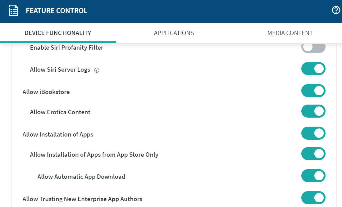

Thank you for your post, do you have any restriction to any unknown application?
Can you please confirm if you have any profile with restriction to disable unknown apps?

3) We do not block unknown apps.

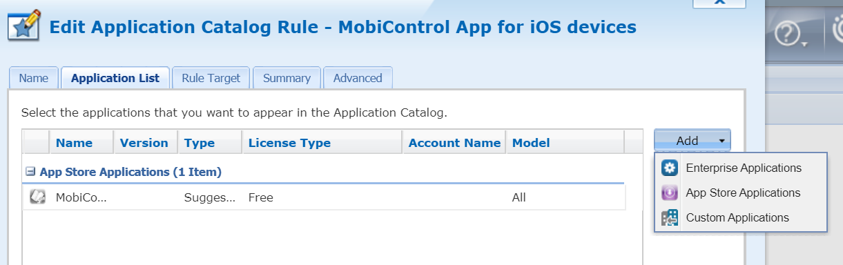

Thank you for your response, while created app catalog rule, please confirm which type did you selected.
