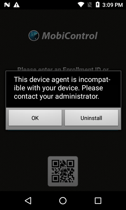

I'd like to enroll my TC25 (BSP 03-11-03-0-NG-00-M1, Patch v3) to Soti MC 13.4 or 14.1. After an enterprise reset I use a StageNow profile to connect to the Wi-Fi, download mcsetup.ini and the Soti agent (ZebraMobiControl1350_1088.apk), install Soti agent and set it as DO. Once agent is started I see the message "This device agent is incompatible with your device. Please contact your administrator". Well, am I doing something wrong? How to enroll TC25?

Hi Radek,
You have to use Android enterprise agent for TC20/TC25 (GoogleMobiControl1350_1110.apk).
http://www.soti.net/oem?m=android%20enterprise

Yes, this seems to work. Many thanks!
