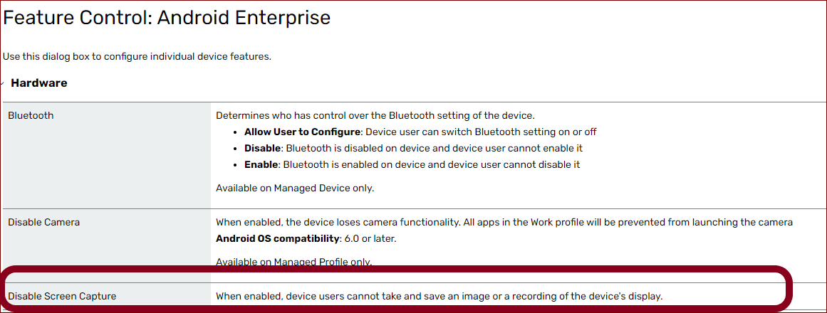

  • Check if you have the following feature control ( screen capture ) configured for that device.
  • Try to Zoom In/Out on the Soti Assist.
  • Restart the SOTI Assist Service under the SOTI Assist Utility.
