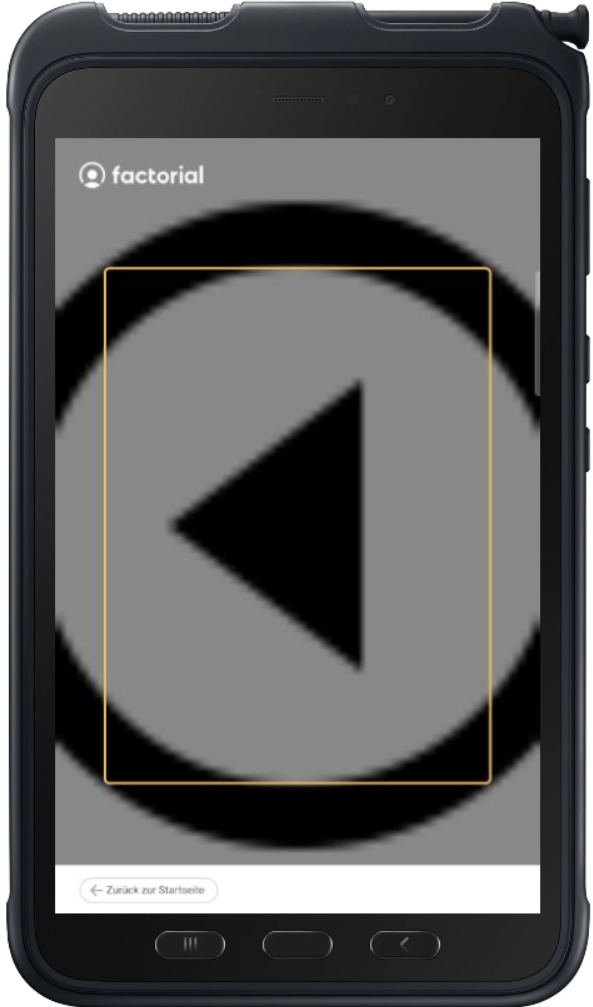

We want to use Samsung Tab Active 3 to allow the employees to clock in/out from the workspace entrance using face recognition. I created a new profile to make the tablet open the URL in the kiosk mode but the camera doesn't open when we click on it. Can somebody please help me to change the camera's permession?
I use SOTI enterprise V. Version: 15.6.0.1018
