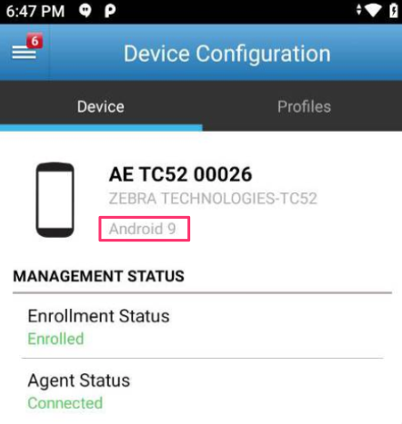

Android Pie (9) is also just around the corner!
