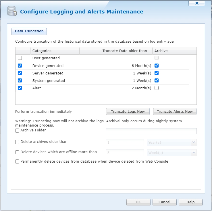

Have you deleted the problematic devices before factory-resetting and re-enrollment back to your MobiControl server?
If so, and the problem still perssts, maybe the device entry in the database got corrupted in some way.   You can consider enabling the "Permanently delete devices from database when device deleted from Web Console"  option (the last option at the bottom) in your server "Global Settings -> Configure Archiving"  before deleting your device with your web-console and re-enrollment of the device.  Before you do that, you might need to perform SQL database back-up in case you need to fall back with the option disabled again.
