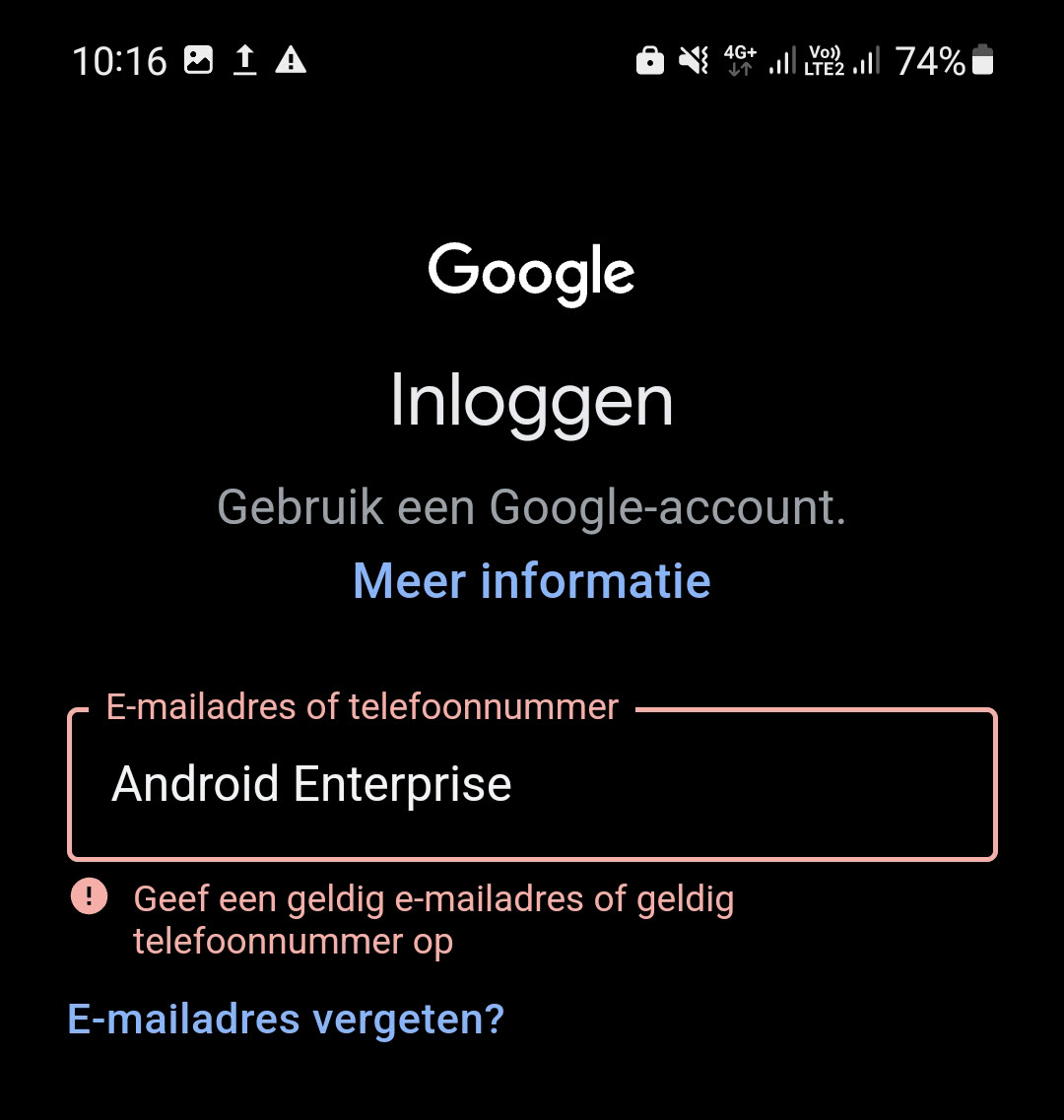

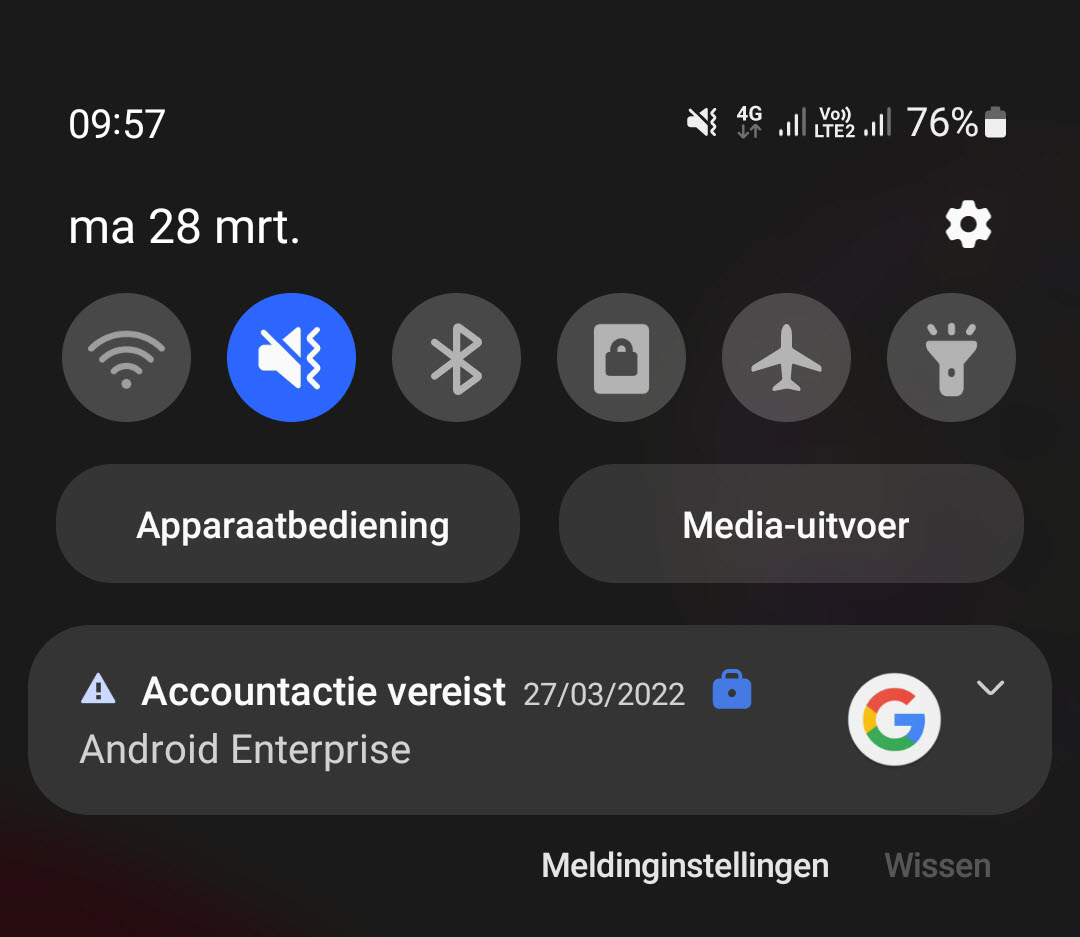

We keep getting the notification that there is account action requiered.
When trying to do this, I get the Google login screen where the e-mailadres field is already prefilled with "Android Enterprise". When clicking continue, it gives an error: fill in a valid e-mailadres.
We are unable to change this field when clicking on it. (No keyboard is appearing and also no cursor, so I guess you don't need to change this).

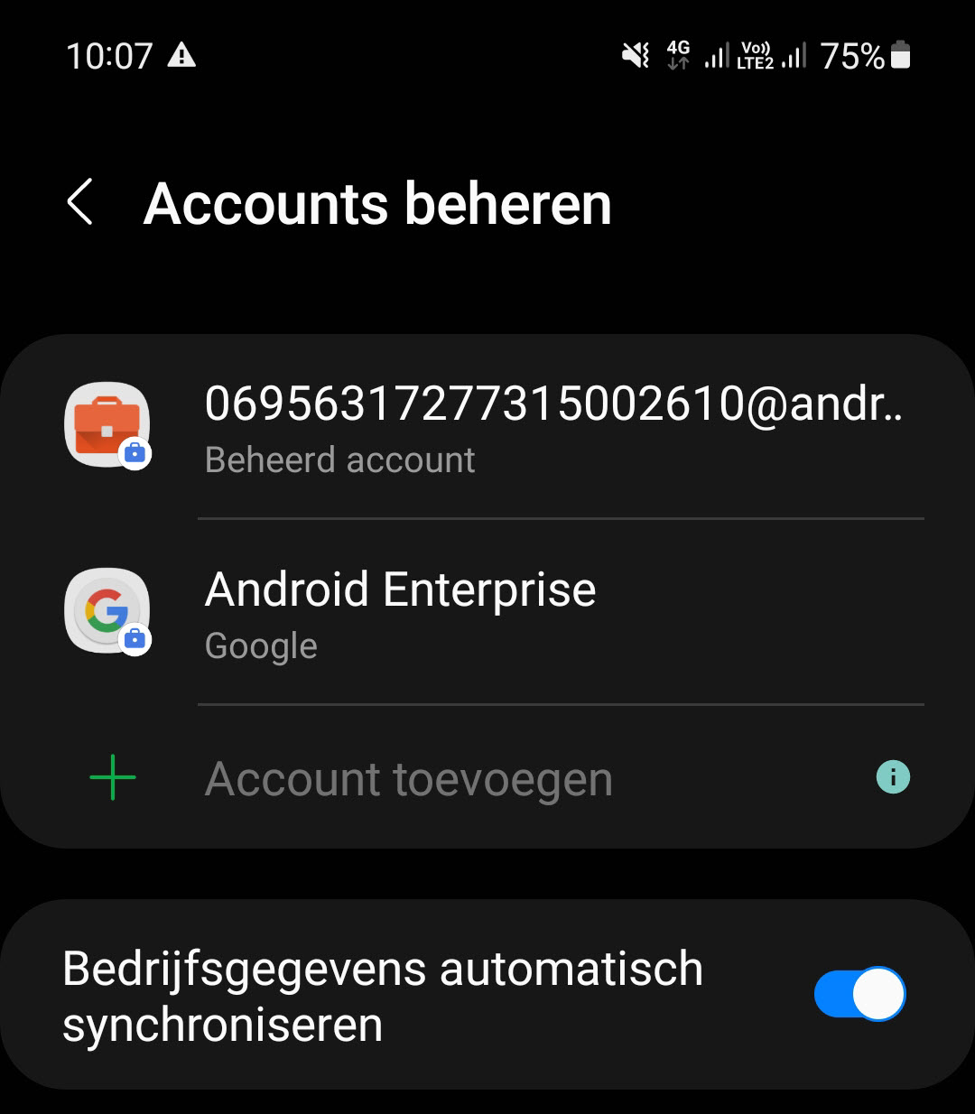

If I check "accounts" on the phone, I see 2 "work" accounts:
What can be the issue here?
